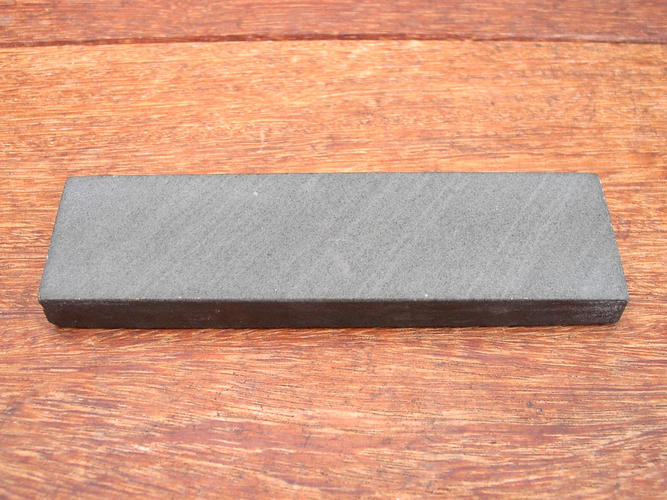

I have used a fine honing stone wetted down with some WD-40 to do my final prep on my gasket surfaces for ages.
Then just wipe gasket surface down with a shop rag and some carb cleaner.

Grumpy: interesting idea! I've tried using plastic razors with no luck, but I imagine something like lexan might stand up to the abuse a bit better.
Dr. Gamma: sounds like a good approach -- Is there any risk of bits of the honing stone getting into the engine using that method?

My little honing stone is like 3 inches long about 3/4 inch wide and about 1/4 inch thick. If you oil the stone the little grit that there is gets suspended in the oily film.
I have NEVER had any of the stone break away as I lapped the gasket areas.
I think my honing stone was made by Norton.
I bought it back in the late 70's. I use it ONLY on gasket surfaces thats it.

Dr. G: Awesome - any idea what grit your honing stone is? I realize that you bought it some time ago, so no worries if not! Otherwise, anything in particular to look for when selecting an appropriate honing stone?
