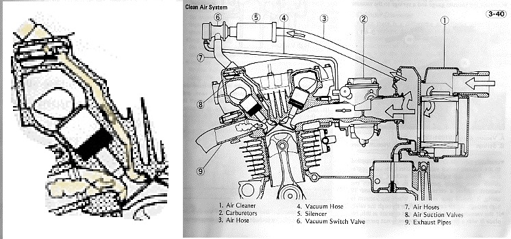

That's not what I ment let me explain. On carbs 1 and 4 there is a vacume line coming off each one and the join together at a t. From their the linen goes to this switch bolted to the gram that goes to a big hose that connects to the air cleaner box. I don't know what it is

I think the switch in question is the "Valve Assembly, Air Switch" as shown below. Ed

The "clean air system" may easily be removed and discarded.

That's it!!! What would the purpose of the valve? Emissions or something?

So pluging this will not harm the engine? More heat etc....

hotdogg wrote: So pluging this will not harm the engine? More heat etc....
No harm.
No extra heat.
No downside (except exhaust emissions).
Removes potential air leak sources.
