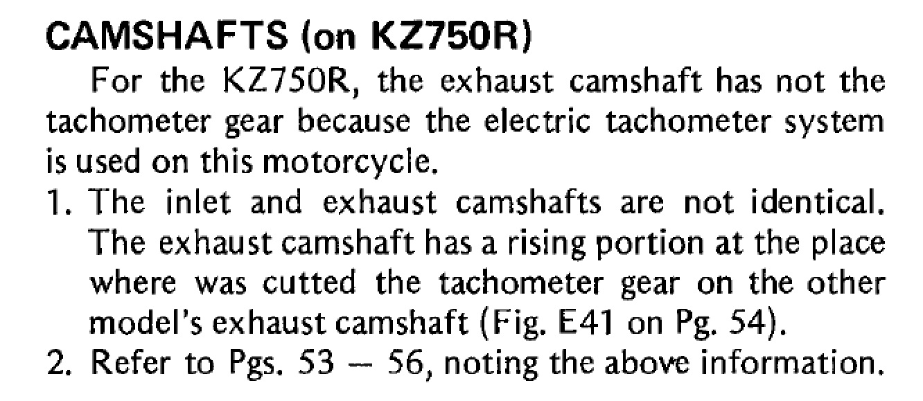

The FSM may be downloaded with this link:
www.mediafire.com/download/tgyn0uywyny/K...ki+GPz750+Manual.zip
At page 304 of the 1982 supplement:
Mcdroid :cheer: may well have the better answer, as I may have missed seeing it or looked at the wrong FSM for the model in question. :unsure:
