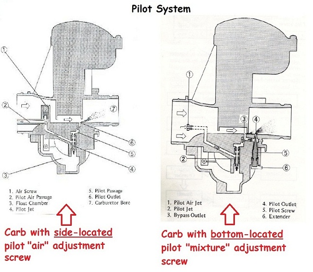

Some non-carb possibilities ---
• Is the stock air box fitted and with a fresh clean filter installed?
• Are valve clearances within specs?
• Has the timing advancer been inspected for proper functioning and to assure that it's properly lubed and not sticking in the closed position?
Perhaps the carb pilot circuit is the culprit -- despite all the cleaning efforts.
It might be that the pilot circuit orifices into the bore are still blocked.
If gasoline was permitted into the freshly cleaned carbs without first passing through an in-line fuel filter, the pilot circuits may have become immediately re-contaminated.
Similar cleaning technique may be used on either style pilot circuit.
Has the clear tube test been performed on each carb to assure correct fuel levels in the float bowls?
Good Fortune! :)
