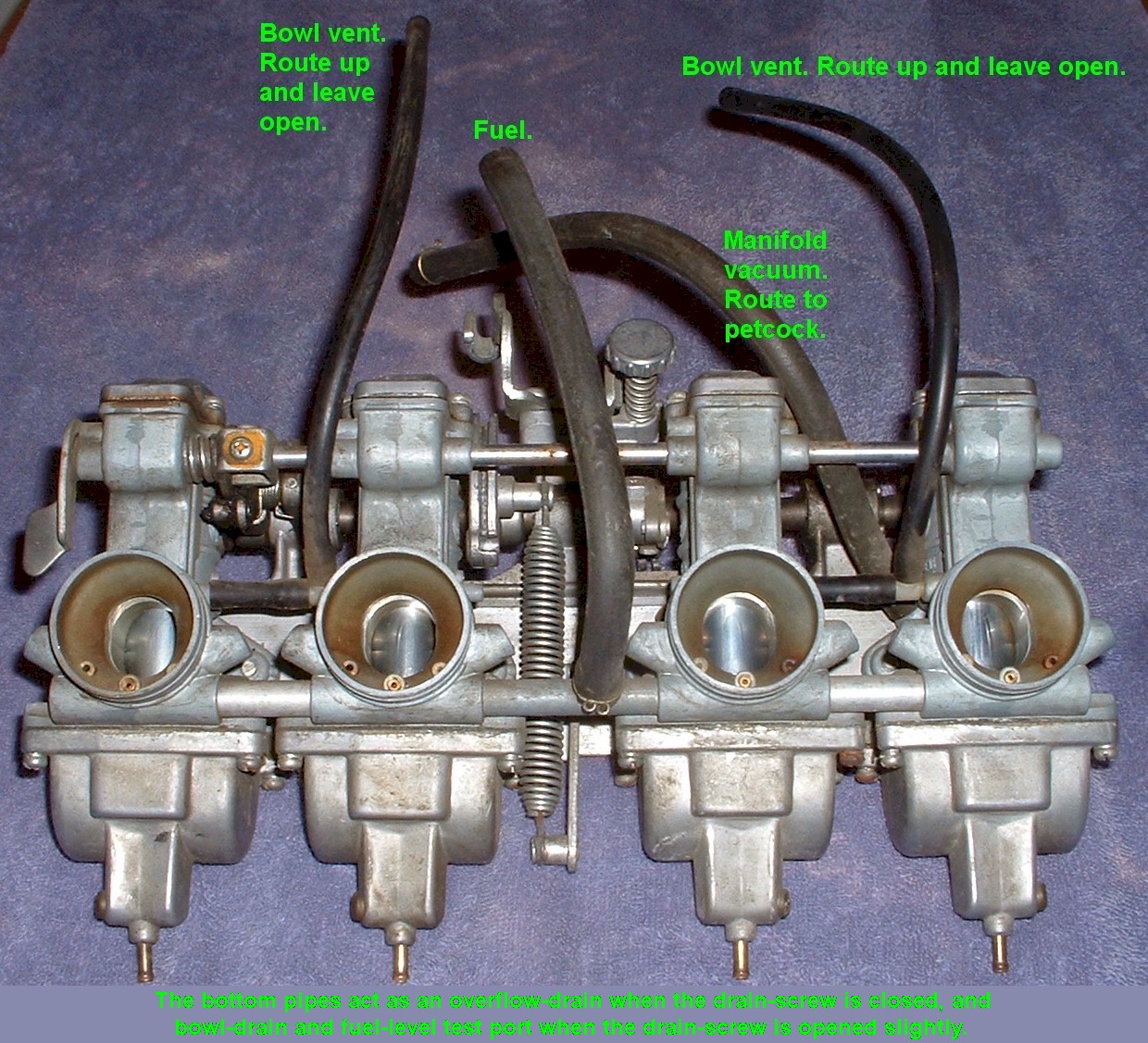

Also, quick question about the carburetors. We pulled them well over a month ago and then ran out of time (I'm in college and don't live here, so the time to drive out here and work clashes poorly with studying), so we're forgetting one thing. There are two hoses that come from the rail that runs across all four carbs on the intake side. Where on earth do those hoses go? They are relatively small, not much larger than the bowl overflow hoses on the bottom.

Hi, I would first say it sounds like you timing isn't right or you got your coils on the wrong plugs. But, that last comment might be the issue too. If you are talking about the 4 vacuum ports on the boots, they should all be capped off, otherwise you have a major vacuum leak. If you are talking about the fittings on the carbs, there is a vacuum port for the fuel tank. If you have the evap emission system on your bike yet, I believe two of the small hoses go to the boot nipples. (I don't exactly remember, I removed mine quite some time ago)

I believe the hoses you're talking about are just vent hoses that route upwards and don't attach to anything

After trying for a bit more, it really sounds like there's just a ton of air in the carbs. Lots of gurgling and burping out the air box. Sounds like maybe a vacuum leak, but I'm not exactly sure from where. It WILL idle for a couple seconds somewhat roughly, but regardless of choke any throttle will help kill it after half a second. The only thing I can think of off hand are those two unknown hoses out the top, intake side of the carbs. They are on that rail running above the openings from the airbox, with one between the first and second and the other between the third and fourth openings. Are they ones that should just run to were ever? The odd part is that one is flanged and pliable on the end as though it's been connected to something, and the other looks quite similar apart from more age.
Are the mentioned hoses shown in this photo or any of the following illustrations?

Ah, yup, they are indeed the bowl vent hoses. Dang, I was hoping those could lead to a solution. Sorry about the mix up with those, I wasn't sure exactly what they were for!
