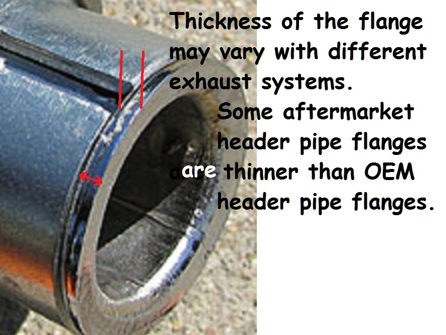

28 Feb 2014 12:50 - 28 Feb 2014 12:53My understanding is that the thickness of the pipe's end flange against the gasket may vary slightly depending on the particular exhaust system at hand.
For example, the stock exhaust may have a slightly thicker flange than a V&H, whereby the slightly thinner flange would require a commensurately longer split collar.
But the extra length would only be the difference in flange thickness (a very slight amount).
Last edit: 28 Feb 2014 12:53 by Patton.
