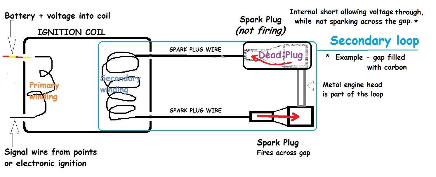

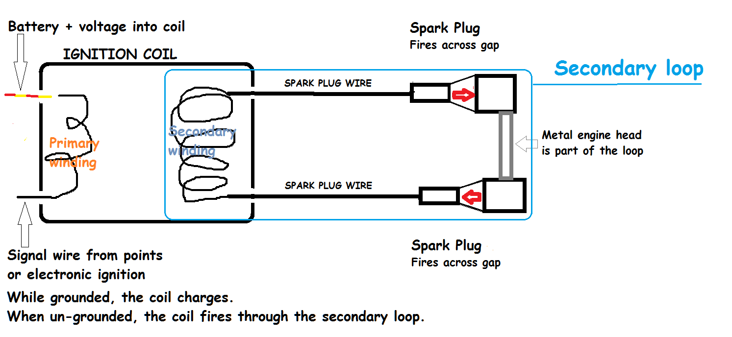

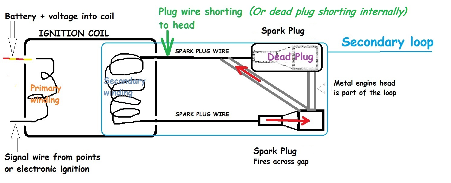

If not already done, would test again with brand new spark plugs per factory specs.
The secondary loop must form a complete circuit for either plug to fire.
If one plug is firing and the other plug isn't firing, the circuit is being completed otherwise than via spark on the non-firing plug, which might happen with conductivity through a non-firing plug, short in the plug wire, or dark witchcraft.

It was dark witchcraft that put a barely visble nick in my points wire insulation that was arcing to frame creating that circuit. Thanks for the ideas guys. Have strong spark now to all 4. Now just have to get rid of this snow and sub zero temps

14 Feb 2014 22:38Patton wrote: If not already done, would test again with brand new spark plugs per factory specs.
One more possible short: inside the coil (transformer) when one end of the high voltage winding arcs down to ground internally.
