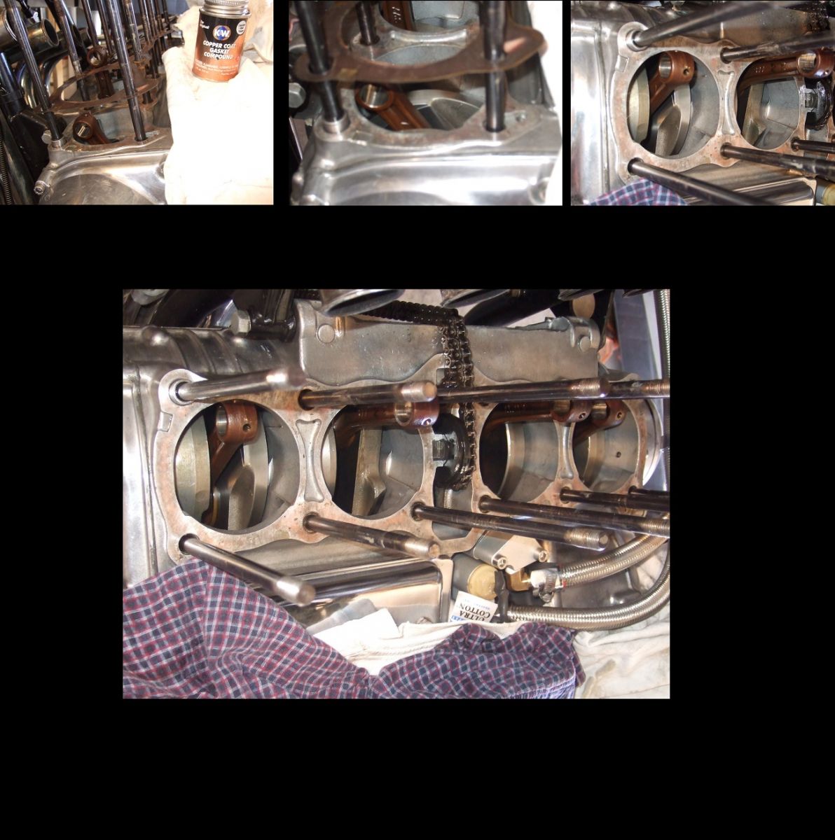

Has anyone used this new base gasket? is there any feedback on it?
Thanks, Spencer

No, don't know what that is. After the problems I had with my gasket set, I always wonder how long the "new old gasket" has been sitting around. The base gasket in my set failed. I ended up making a new base gasket from the 1/32" gasket material from auto zone and it has worked perfectly.

Kawasaki changed all of their gaskets from the black colored gaskets to those new red colored gaskets back in the late 90's if I remember right. The black gaskets contained asbestos and other nasty things, but they sure sealed up real nice!!!! The replacement gaskets never sealed as good as the old black ones. I had the service department and over the counter customers bitching about the newer gaskets weeping back then. You can thank our wonderful government for all the new style asbestos free and prone to leaking red gaskets.
After seeing all the problems with the newer "environmentally friendly" gaskets. I bought all the older style black colored gaskets I could after that. I still have at least 5 to 10 of every old style black colored KZ900/KZ1000 gasket stashed away in a big sealed Tupperwear container.
I would use some good old brush on K&W Copperkote on all those newer gaskets. Make sure you get the inner and outer edges of the gaskets too.

I have used the newer "RED" gaskets without any issues what so ever but..... I am very careful with gasket surface prep. but them again with any gasket I am careful with surface prep that is the key!!!

I would use 3-bond on the base gasket. As rarely as it ever comes off, the added sealing effect is well worth it.
