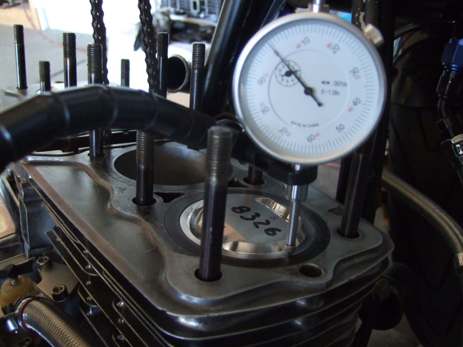

My 2 cents since this occurred in my first buidl (Wiseco 1015)...
Unless you're the originial owner of this bike, you'll have no way of truly what was done to the old girl after 30 years of previous owners performance builds, head decking, cylinder base machining etc...
As with my Wiseco kit, had to double up the cylinder base gaskets due to MRE over machining the 10,000"... When encountered and measured, found measured in more at 17,000ths... Double up 2 cylinder 20,000ths base gaskets, head decking on the money once torqued down (squish factor ~ 3,000ths).... Then confirm head decking...
Anytime building new performance, must always confirm head decking.... No likey bent valves... :pinch: :whistle:
All gaskets other than head 1 or 2 piece gaskets (go on dry) I've been using K&W copper spray, works well... Or as mentioned by Larry, use case sealer, same results...

You might have J model pistons instead of KZ pistons. In any event you need to space the block up. Use a setup like Dave did and get your actual deck height. Order the correct spacer to get to zero.
