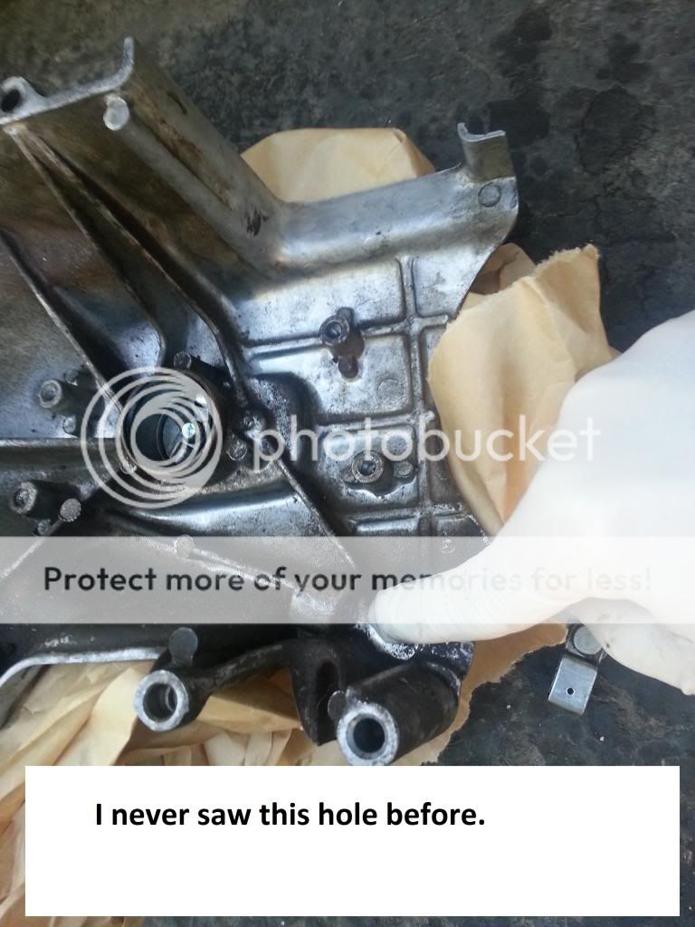

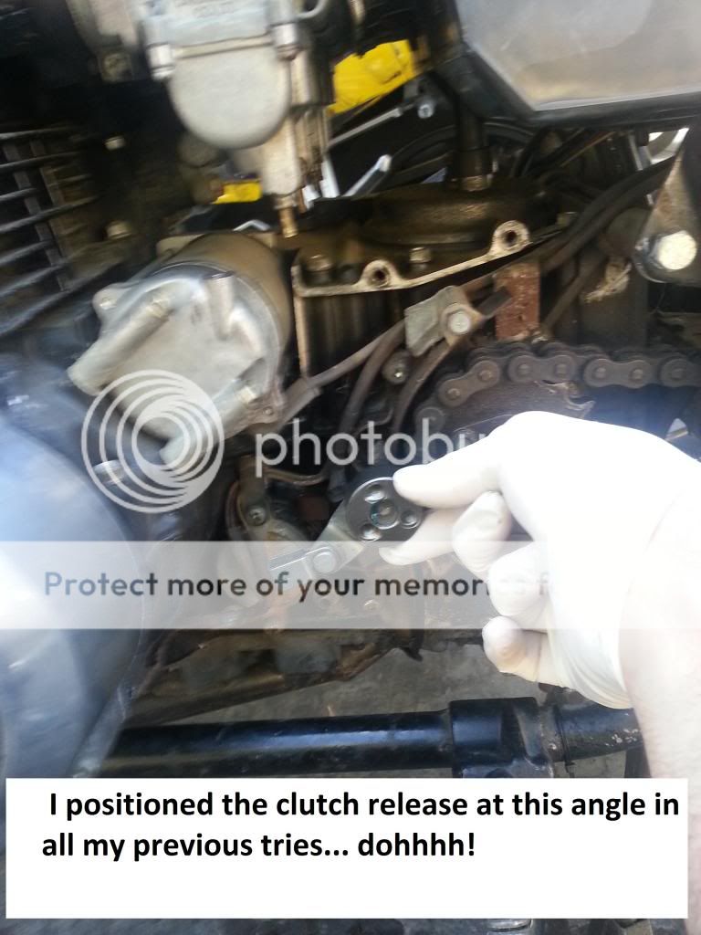

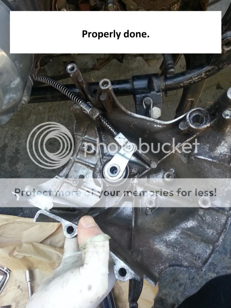

I FINALLY finished the job up and drove my bike home today...it was a special ride.
It was 40+ miles and my first long-trip ride with this bike.
Thank you everyone for giving me tips and helping out.
Martin, your last post was the "ahhh-hhaa" moment and everything clicked together...thank you.
The job after that took only about 20 minutes.
I was rushing things and never saw the sprocket hole for the cable to go through...after seeing that it was done.
Everything made sense as to why it wasn't working.
I learned A LOT from all this trial and error and next time around I learned how important ATTENTION TO DETAIL is.
Thank you all once again.
