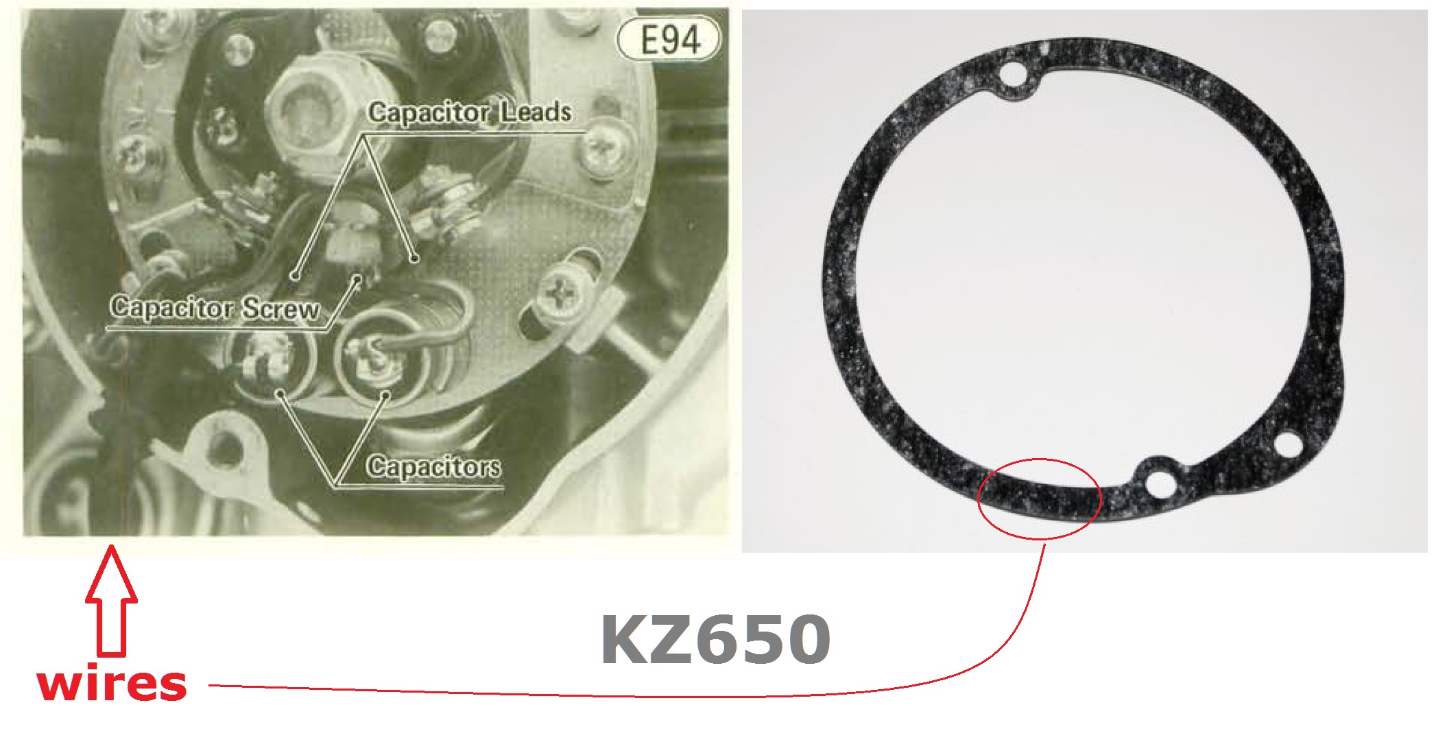

I believe that notch is intended to prevent oil from accumulating inside the case and fouling the points if the crankshaft oil seal or oil pressure sensor leak. I don't know about later KZ650 models, but early ones also have a little hole drilled through the engine case near that notch in the cover for the same purpose. Don't plug it; it is supposed to be there. Ed

FSM pic of inner cover doesn't extend to the hole location area :
For comparison, Z1 has in the inner cover -- a separate part -- a wiring grommet hole and a vent (weep?) hole.

The hole, for whatever its designed purpose, should be left open.
Air vent
and/or
weep hole to allow water from condensation to escape
and/or
drip hole to allow unwanted accumulation of oil to escape
and/or
and/or
Last edit: 25 Nov 2013 07:33 by Patton.
- Posts: 15333
- Thanks: 2833
Re: Points cover question..
25 Nov 2013 07:46Patton wrote:
Thinking, but not positive, that the KZ650 doesn't have the separate inner cover.
Correct. The points cover on the KZ650 attaches directly to the engine case. Ed
