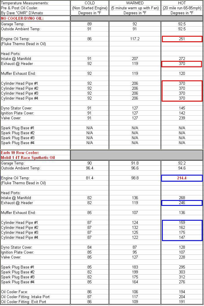

The cooler really does work.....OMR, has posted some numbers using the cooler and they were very positive.

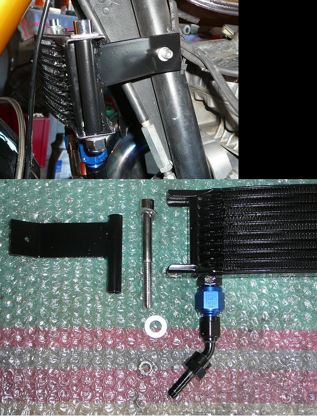

These coolers are lightly soldered. It doesn't take much to break these joints.
If you mount this cooler 100% firm......it will fail.
You can see the 1/8" orange-ish rubber in between my mount and cooler in pic above. I also didn't torque the bolts down either.

Made my own cooler mounts, used the side reflectors threaded holes for securing to the frame.
As for results/do they work, as mentioned bike has to be moving to be effective. Here in AZ, oh yeah needed for too freakin hot in the summer with out... Synthetic oil helps as well where it doesn't break down as quickly thus keeping the lubricating qualities. As I do, change the oil frequently as well...
