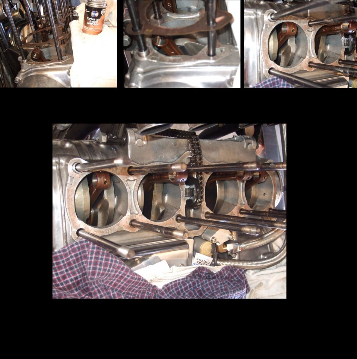

- Old Man Rock
- Posts: 6071
- Thanks: 225
Re: Base gasket oil leak.
29 Oct 2013 02:27
Works/seals every time and gaskets come off clean when required....
Note gasket on a 1075 build coming off clean...
