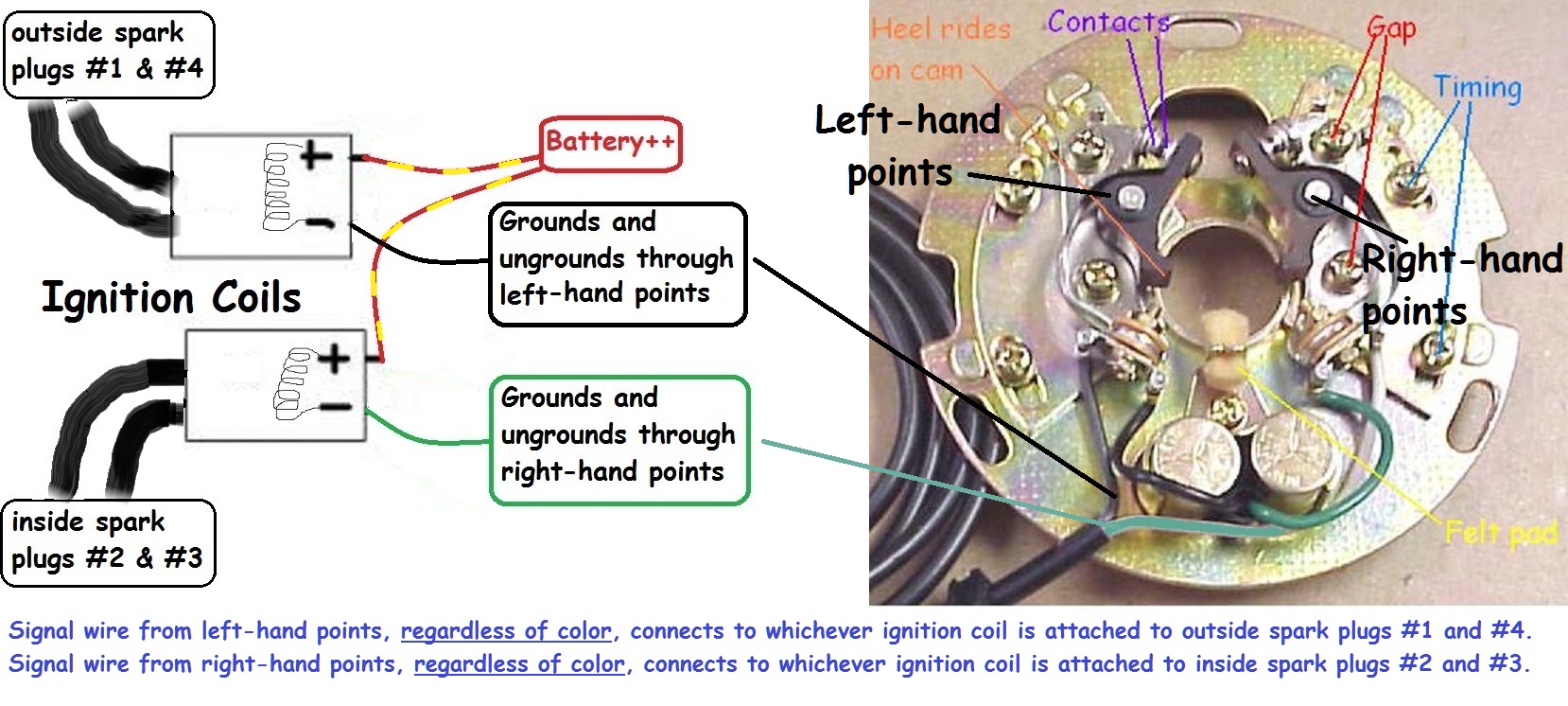

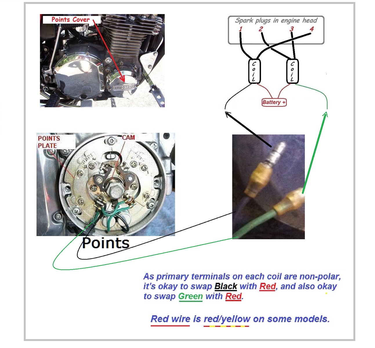

Is it possible the previous owner hooked the spark plug wires to the wrong plugs or attached the wires from the points to the wrong coils? Check to make sure the wire coming from the pair of points marked 1/4 goes to the coil that attaches to the spark plugs for cylinders 1 & 4. Ed

It's not unusual for the plug wires to get switched - the 'right vs left' is by convention. For example, if the wires on your points got crossed up, they would be feeding the wrong cylinders, because they would now be pulsing the 'wrong' coils. I'd make sure the coils are wired right before I went much further. Follow the green wire from the right hand points to the coil. Follow the plug wires from that coil to the plugs and make sure that circuit is feeding cylinders 2 and 3. If that one is right, the other one is right (there's only right or wrong, not combinations of each).
