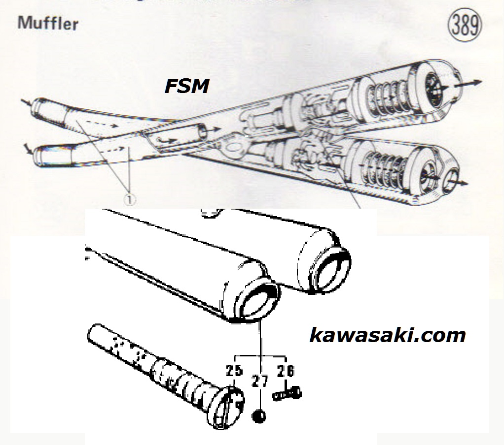

- Posts: 18568
- Thanks: 2101
Re: Engine Exhaust Rattle
19 Oct 2013 10:54
No eBay APP ID and/or Cert ID defined in Kunena configurationFor reference:
kawasaki.com shows baffle tube part no. 18033-058
Perhaps some fiberglass wrapping?

Patton, thanks for the pic, it will help to explain my problem.
Looking at the pic, if you can imagine the baffles removed. There looks to be two circular plates that support the baffle.
I believe it is the second of these circular plates (the one furtherest from the end) that has come loose or un-spot-welded.
My method would be to concentrate on this, by injecting POR15 thru the first circular plate into the second cavity, and allow it to cure. Any surplus I would allow to flow around the first plate.
Daveo, I could be completely wrong with my analysis of the rattle. However, the header is an integral part of the pipe, hence my reluctance to go there at this stage. I must admit when I hit the header with the palm of my hand I do get a rattle, however the noise is a lot more prominent at the muffler end.
