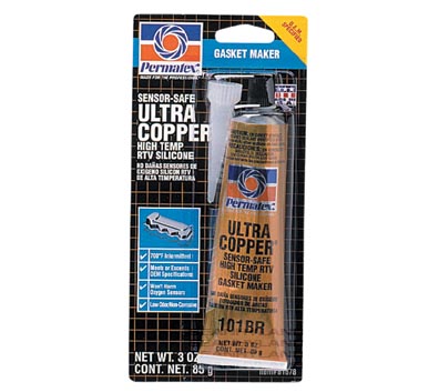

If the exhaust area is cleaned, Permatex high temp copper sealant may be another adhesive option.
The product should be sufficiently heat resistant, because it's used satisfactorily to help seal the copper gaskets in exhaust ports.
Just before metal-screwing or pop-riveting, the sealant could be applied between the repair plate and muffler to better seal the holes and help avoid possible vibration.

17 Oct 2013 07:28I agree with this approach. By themselves, neither provides a quality seal. However, combined they just might do the trick.Patton wrote: If the exhaust area is cleaned, Permatex high temp copper sealant may be another adhesive option.

You could attach a plate w screws in addition to the sealant. The screws will keep it in place & the goop will seal it.
