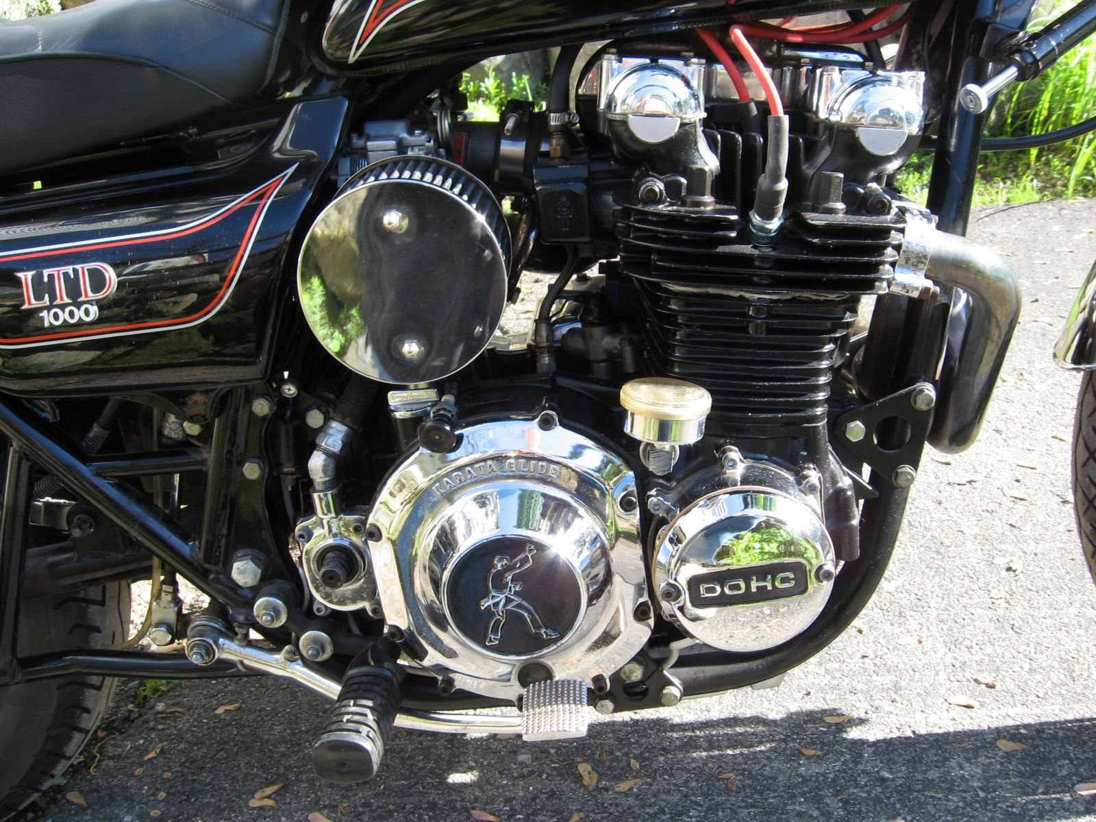

Like this on my 78 LTD

barney wrote: ... The plug I refer to is threaded horizontally into the motor right rear corner just below the cylinders
I should've realized it's the OIL PASSAGE PLUG part number 92066-021, which kawasaki.com shows applicable to 65 Kawasaki models, including Z1 and J models.
The gauges are available (at least they used to be) for mounting either facing upward or facing to the right.
