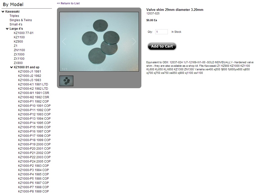

what size are the valve shims on my 2002 P21 police bike KZ1000
are they 29m
are they 28m
they are over bucket type if that helps
the reason a ask is Z1-interprise only sells 29m is this correct?
again thanks for the help

Yup - Should be 29mm...
Same time, have an old shim, measure it with a caliper just to be sure...

just looked in my documents on bikes valve set-up and there it was 29mm well.

29MM Yamaha shims will work too. Only difference is the shim size starts with a "Y".
