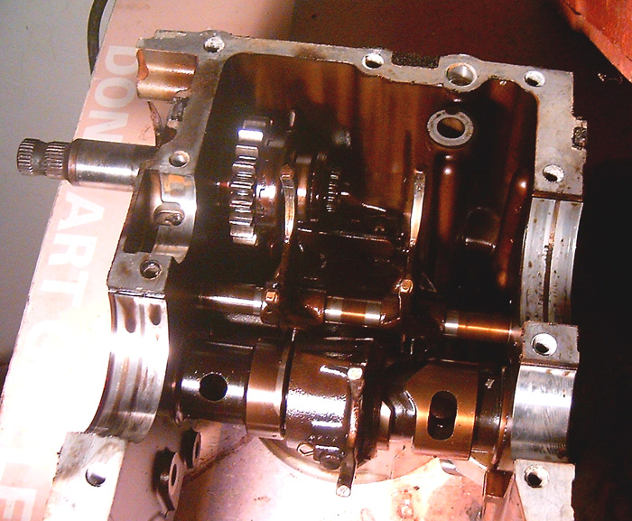

You can't remove the kick shaft without splitting the cases, it's physically impossible - as you can see in the pic below (my 650 engine), there's no way to get the shaft and ratchet out past the shift forks/shift drum and transmission with the cases assembled.
If you're really determined to get rid of the kick and don't want to split the cases, your only option is to cut the end off the shaft and leave the remains behind the non-kick cover - not an ideal solution, but it´ll work.
Edit: Btw, if you do cut the shaft make sure you have enough shaft left to install the kick lever return spring and sleeve as that is what keeps the kick start ratchet disengaged.

Thank you! That's a perfect shot showing why, too.
I guess now I'll have to decide if I want a neat looking CSR cover and lop off the end of the shaft, or purchase/machine a simple cap for the end of the shaft sticking out.
