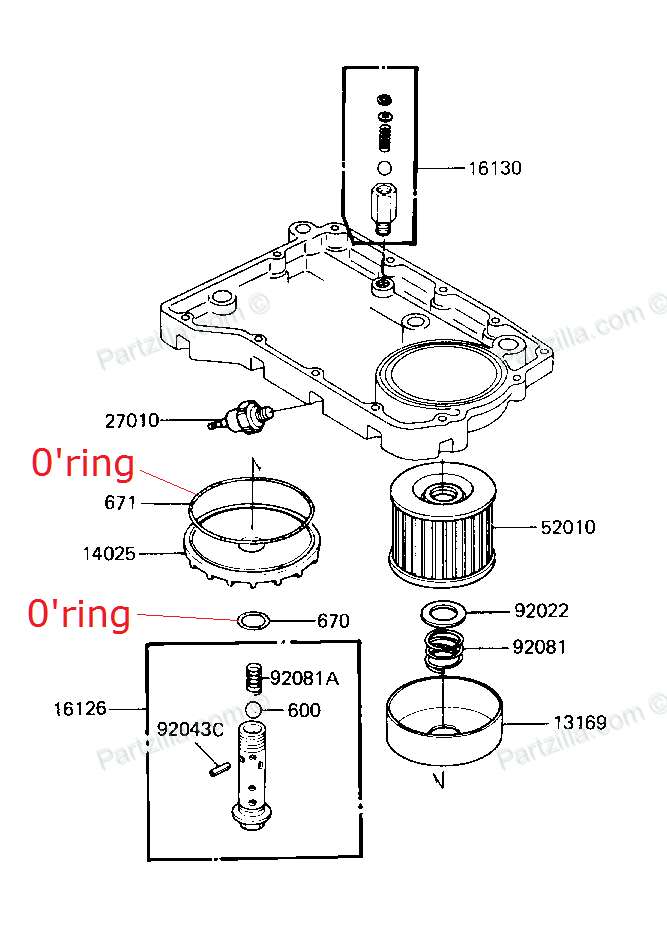

The O-ring 670 in Patton's diagram, should be on the neck of the bolt, near the bolthead end. This needs to fit snug, once on the bolt, into the bore of the filter plate. You can check this with the bolt and plate removed.

I thought the o-ring for the oil filter bolt was 670B2016, not 670B1508.
670B1508 is only 8mm in diameter.
