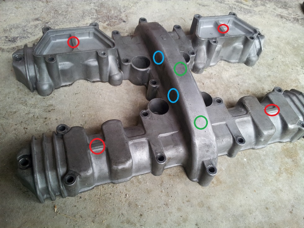

28 Sep 2013 17:19 - 28 Sep 2013 17:29Decided I'll try opening up my valve cover to improve breathing. Wondering where to drill, and how large openings should be.
In the attached picture, red circles are over cam caps. Not as much oil blowing around, there, maybe. Might not be as effective for pressure relief.
Green circles are on top of the timing chain well. Crankcase pressure would be coming up this well, and this would be a good place to provide breathing. Maybe more oil flying around here?
Blue circles are on the side of the timing chain bump. Maybe less direct flinging of oil from the timing chain, here.
How many holes, and where? Blue, green, red or a combination of..
Assuming I'll have to drill and have some kind of spouts welded on. Not much metal thickness for threading, and not much room inside for threads to stick through.
Thoughts and ideas much appreciated..

Re: Endless Oil Leaks
28 Sep 2013 18:31
I've seen where they have plumbed where the blue circles are but only used one right in center of the cam chain hump. Also used the smog caps to vent.

Special thanks to Powerstroke_fan - for the picture and the thread link. This is the route I'll take- fresh breather holes where the smog equipment was.
Hope this is the fix..!
