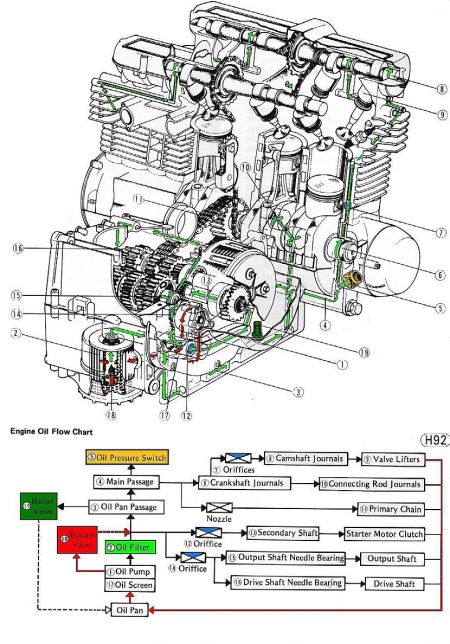

The oil drains back through the cam chain tunnel to get back to the crankcase :)

Also there is holes at the bottom of the buckets that run to the cam chain tunnel.
