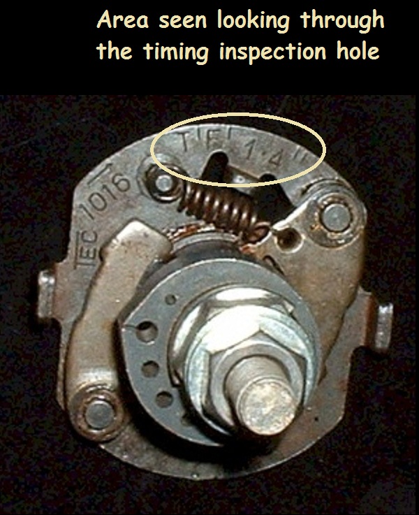

Would lube the weight arm pivots on the timing advancer.
May use a drop of motor oil on each of the two pivots.
May access the pivots via the timing inspection window.
Inspect the weight arm springs on the timing advancer to assure that the weight arms are consistently being freely pulled back to their fully closed position.
The advancer isn't supposed to look like this:
