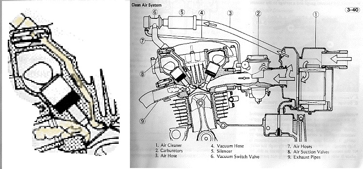

hi i just put some 54mm air pod on my bike and im not sure what to do the the vacuum line that ran into the top of the air box should i just leave it open or plugged?? switched main jet to 132 im in the middle of this so any help would be great Thanks!!!

the vacuum switch hose i think should it be vented or plumed or open

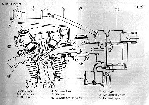

The larger hose is just an air hose from the air box, providing filtered air to the clean air system.
It's not a vacuum hose.
Many owners opt to remove the clean air system paraphernalia.
If desiring to retain the clean air system, with pods, I suppose a separate appropriately sized air filter could be fitted to the end of the larger hose than now doesn't have an air box to draw from.

When installing pods, the Kawasaki clean air system stuff is usually removed. If you go that route, you'll need to disable the valve cover ports.
