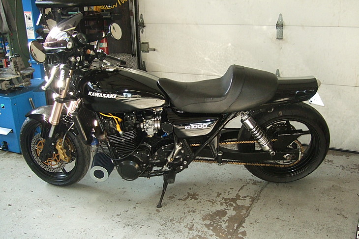

- Posts: 4984
- Thanks: 2148
Re: adding a turbo
10 Jul 2013 09:15
Here are a couple pictures of what it should look like. Turbo up front, thru the intercooler, then to the carbs or injectors. Figure 5 to 8 Grand easy regardless of low boost or not
Good Luck.

lol fuck thats sweet as all hell. i can get all the parts for really cheap/ build parts myself just where would i find a hookup for the carbs and how big an increase in jets? and damn 3-5 you dont see a reason.. lol seems like a bit for a normal rider, how much are you pushing through that bike?

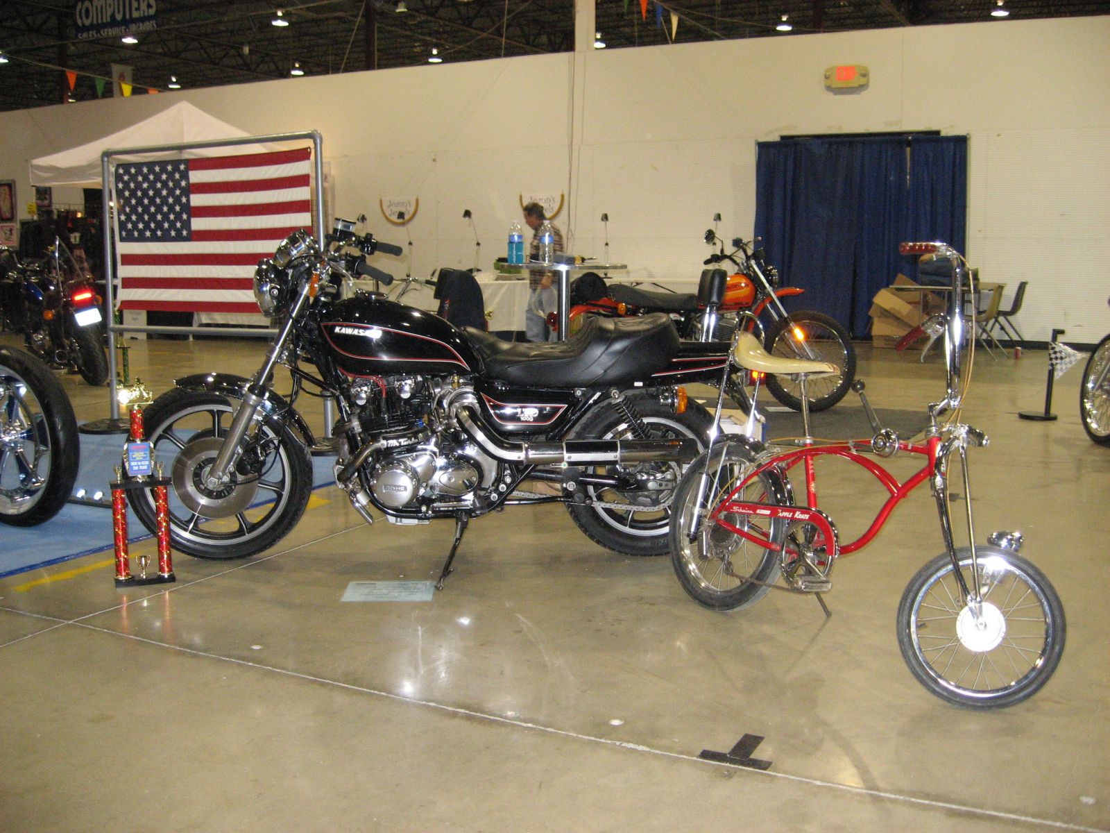

- Posts: 4984
- Thanks: 2148
Re: adding a turbo
10 Jul 2013 22:35That bike is not mine. I found those pictures while surfing last year and admired the layout and execution of the design. It is a great example of a custom turbo setup. Design is a lot like a Kaw 750 Factory turbo, just bigger.KZ-Izzo wrote: lol fuck thats sweet as all hell. i can get all the parts for really cheap/ build parts myself just where would i find a hookup for the carbs and how big an increase in jets? and damn 3-5 you dont see a reason.. lol seems like a bit for a normal rider, how much are you pushing through that bike?
I run 15 to 20 pounds of boost all the time on my bike and I take it up to 30 when someone needs to be spanked or my son is on it and he is not afraid of it at all.
Here is a picture of mine . Its a Mr Turbo Kit I installed in the early 80s. So I can testify if you build them right , they will last.
