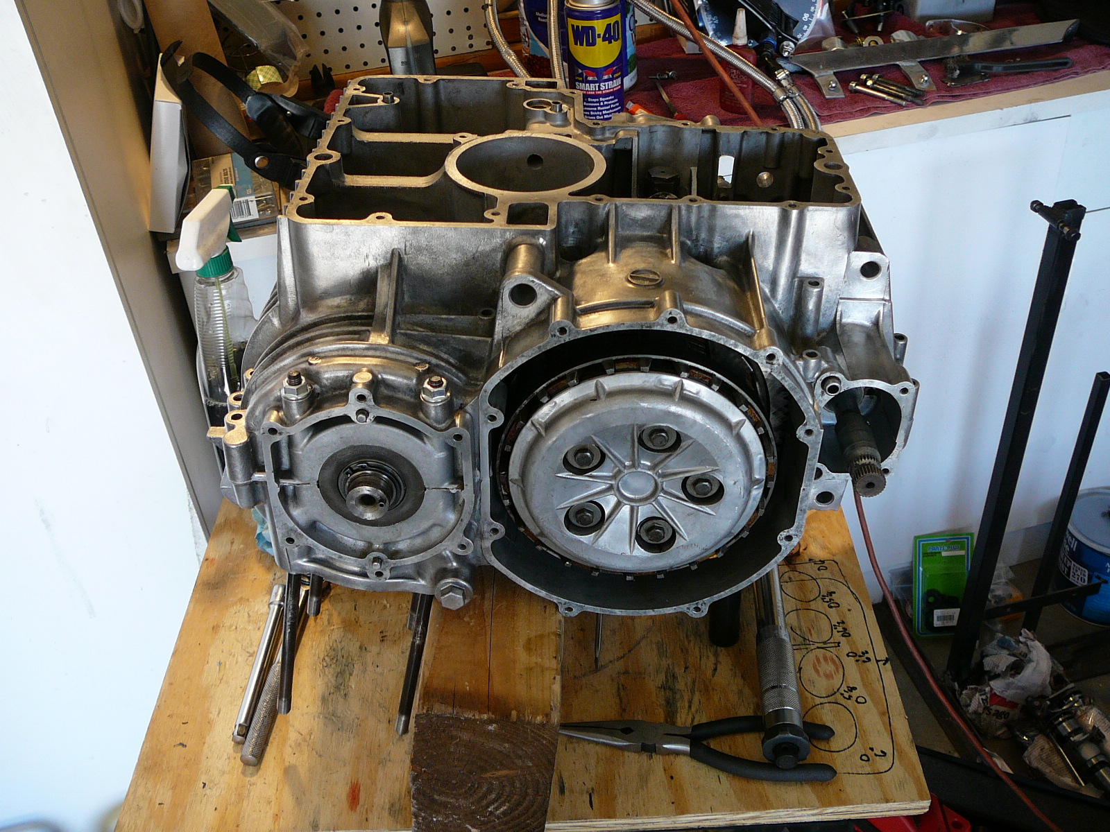

This did great for me too must of rotated it 8 or 9 times each way while cleaning.
29.95 at farm and fleet for the stand, and then 15 for the bolts washers and nuts along with a 2 foot piece of 1 and a quarter inch angle iron. Wedge a 2 by 4 in the front of the motor to help support the weight when not rotating.
