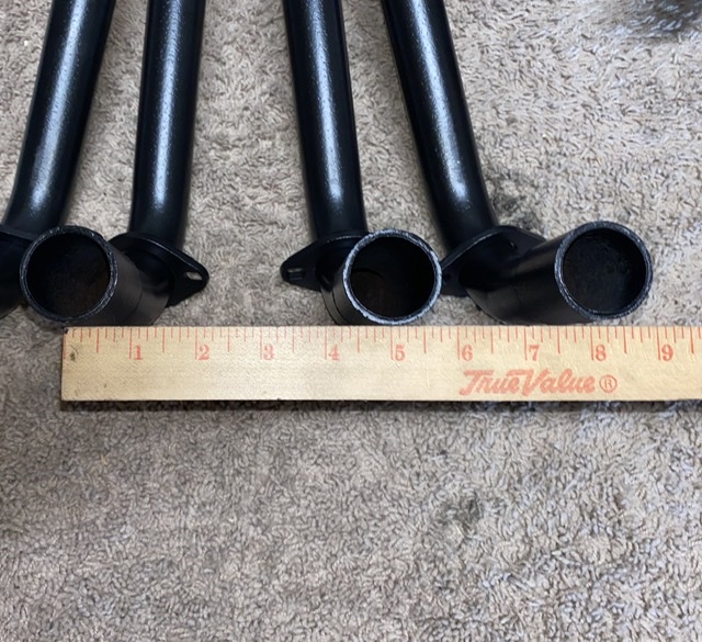

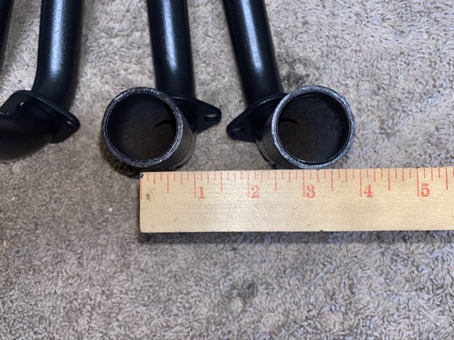

I measured three different 650/750 headers and got three different measurements.
The distance between 1-2 was pretty much 3-1/4”.
It was a variation of 4-1/8” ~ 5-1/8” between tube 2-3.

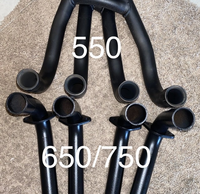

I didn't have to use any heat converting a 650 header to fit a 550. Then I converted the same one back to 650.
I just wanted to know if it could be done. It turns out the extra height from a 650 header makes it hang too low under a 550, so it ends up looking weird.
