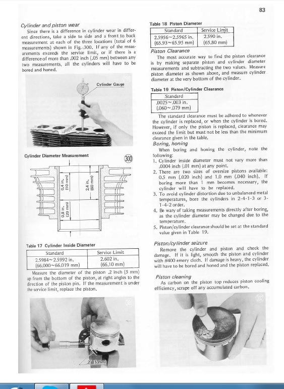

Here's a direct link to the FSM included in KZr's FILEBASE:
www.kzrider.com/filebase/doc_download/43...asaki-service-manual
See page 83 for bore specs.
