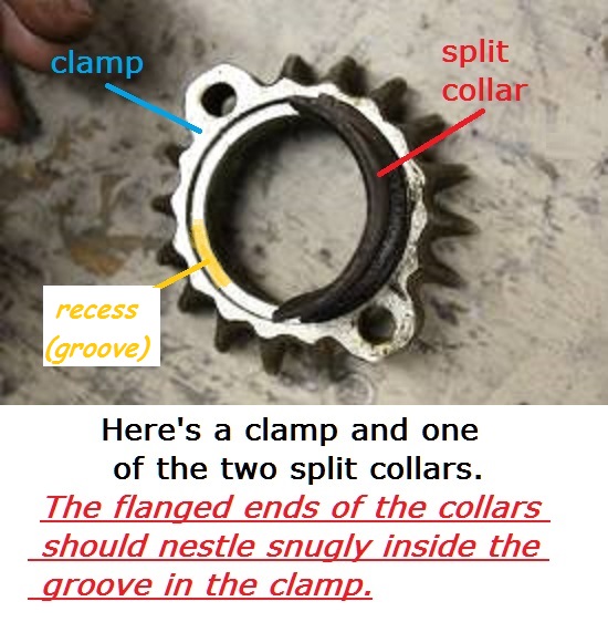

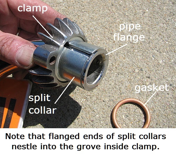

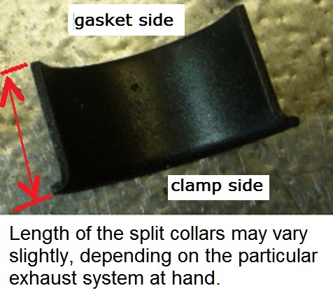

I feel a little stupid right now. The headers came with the bike, but it was not attached. I now see that the header is certainly not made for this bike. The pipes are slightly bigger diameter, and will not fit into the exhaust ports on the engine. I guess that is why the clamps don't fit!!
Thanks for the help. The images are very useful, as I was unsure how they worked.
