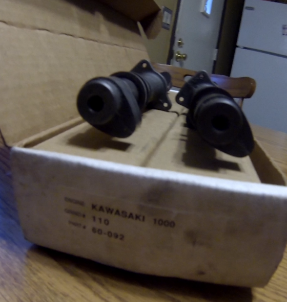

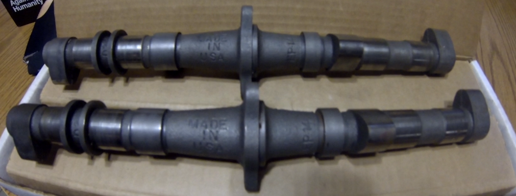

Can anyone help to identify these cams? I can take as many additional pics as needed.
They are in a Web Cams box, with the 60-092 on the label. However, I have no way of knowing if that is the correct box for these cams. Any help is appreciated!
I know they fit the 900s and 1000s, but thats about it.
Various markings on the cams:

if they are Web 110's they will measure around .395 lift, 284 duration. usable with shim on top bucket and high compression aftermarket pistons.......110 should be etched on one end of each cam
NOTE: you have two intake cams...no tach drive gear or for use in something with electronic tach

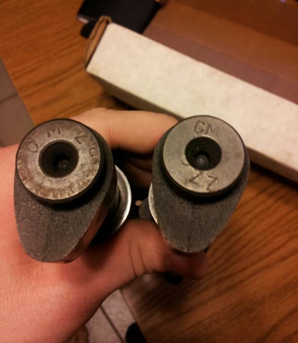

I didn't notice those etchings at first! I updated the first post with picture of the ends. The one on the right shows CM Z7. The one on the left is harder to read, but looks like it shows CM 67.

they are not web's they are cammotion

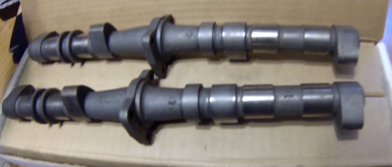

:blink: you have 2 intake cams, Cammotion a Z7 .(429 lift) and a Z9 (.465 lift) both need shim under buckets H.D. valve springs and aftermarket pistons......... :S

you are reading it wrong the one on the left is CM Z9 part of the Z and 9 was miss stamped .... :pinch:
All Cammotion Z series start with a ZZZZZZZZ EXamples, Z2,Z3,Z4 Z7, Z9 Z10 etc.....

close to a web 122 cam set .460 intake and .435 exhaust... :huh:

Designed for Super-Gas type racing engines. Cams have a reduced base circle. Requires High Compression Piston, Shim Under Followers, and Performance Valve Spring Kit.
