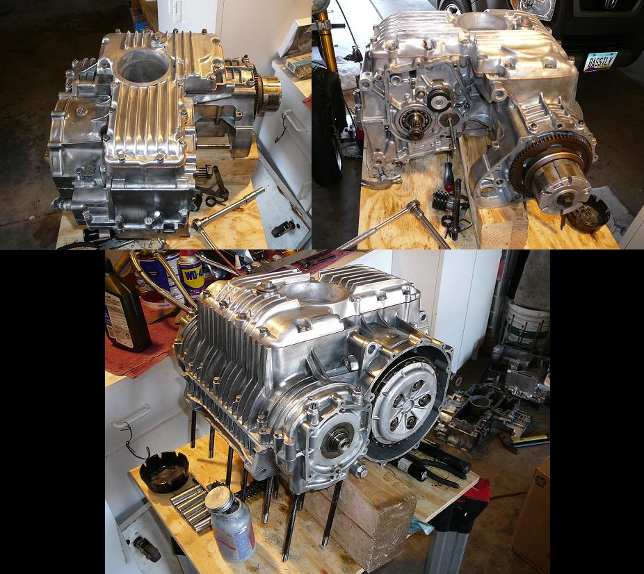

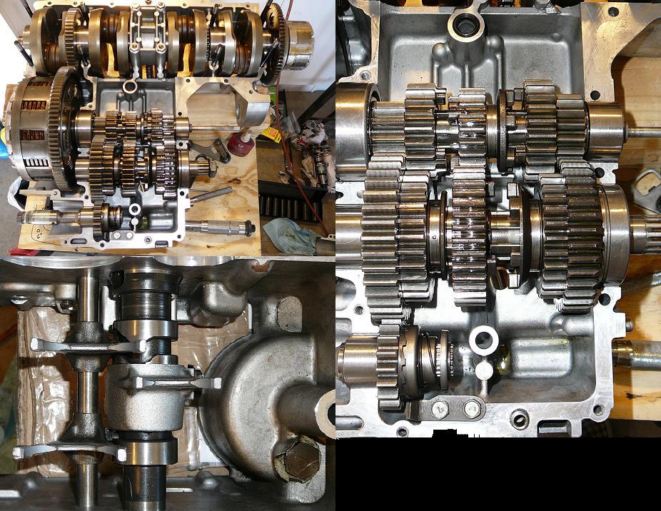

Yeah, I'll definitely be re-checking all of my oil passages. I gave everything a good shot of parts cleaner and compressed air before I put the cases back together, but I think I'll do it again. And maybe once more after that, just to be sure.
I found a little of this sludge around the sides of the oil pan, and a bit at the bottom of the clutch housing, but nowhere near as much as what was in the pump. I wonder why so much of it collected in there?
Man, I sure am glad I popped that screen off. The crud wasn't really visible from the outside, but there was some old pieces of sealant and other debris on the screen, so I thought I'd better take a look inside. Then I was like :sick: .
