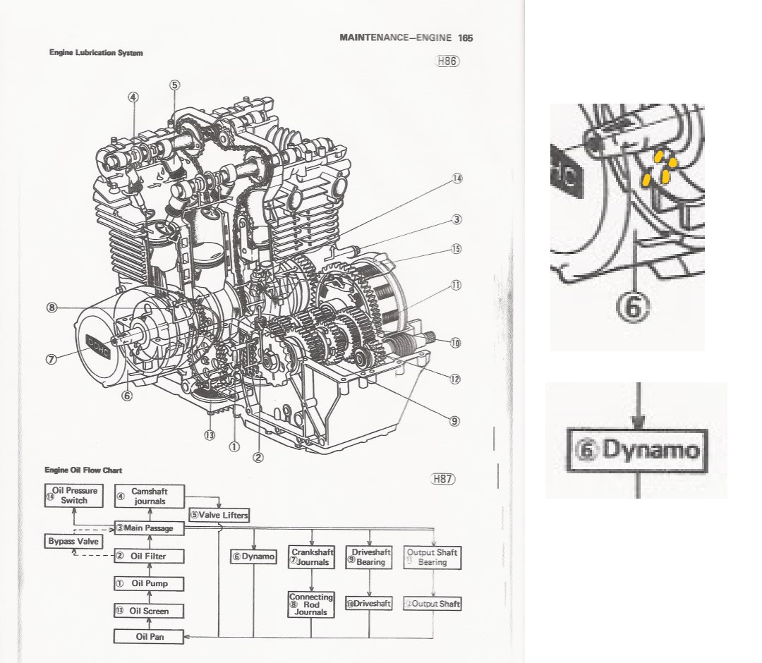

I was replacing gaskets on a 1982 kz 1100 a shaft and there was oil in my stator cover. Is this normal or is this a problem? I appreciate any input.

Its normal in my 78 1000

Some models have oil behind the stator cover, because they don't have an oil seal on that end of the crankshaft (pretty sure). There may be a weep hole for the oil to drain back into the oil pan?
For comparison, the 81 650 is dry - the oil seals for both ends of the crankshaft are listed in the crankshaft diagram. The crankshaft diagram for the 1100-A2 doesn't show any seals, but the engine covers diagram shows one on the ignition side.

It is normal on all 900 thru to 1100 KZ's so no need to worry.

The oil is lubrication, & provides cooling for the stator windings and the starting clutch behind the alternator rotor. That's why it's important to use the correct engine oil, not some oil designed for a car, as "Oil is Oil" does not apply.
