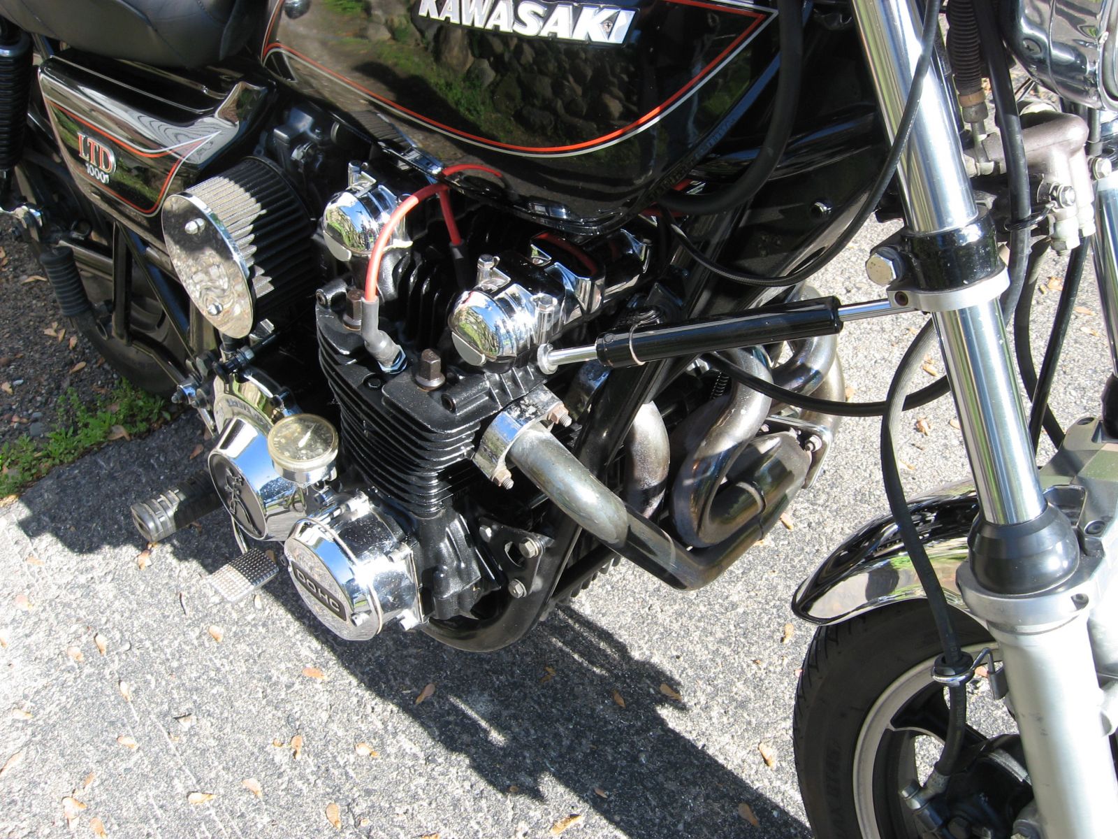

14 Apr 2013 19:21Thinking of wrapping my exhaust header in a thermal wrap. Seen some nicely done pipes and it could be a good thing for a couple reasons.
My header primary pipes are getting a bit tired in the finish and This seems to me to be a good way to freshen up the look and function for a bargain price.
Looking for a black or silver tape which can live in the high temps of a turbocharged 1075 motor.
Not only should it look good but hoping to help lower air temps at the front of the motor to promote lower cylinder and head temps and lower the temps for the upcoming oiler cooler which will probably end up being mounted below the collector. Unlike on non turbo pipes I have alot of room for a cooler low, but still high enough to not hang below the engine where it could get beat up.
Anyone have any experiences to share ???

I know pictures can mislead, but your pipes look good. Wrapping them invites rust. Ed

They do look good , but the primaries are getting rusty where they come together at the collector. Sending them out this year to a powder/ Ceramic coater is not in the budget this year and was looking for a affordable cure to buy me some time. I have heard pros and cons on the wrap holding moisture , But that seems to be a problem with bikes ridden in the rain that arent ridden till the pipes get a chance to boil off the water.
