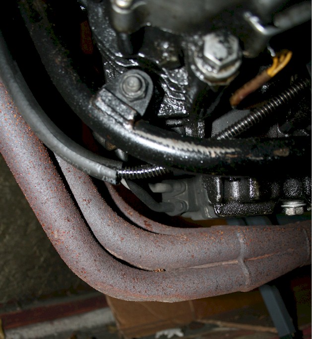

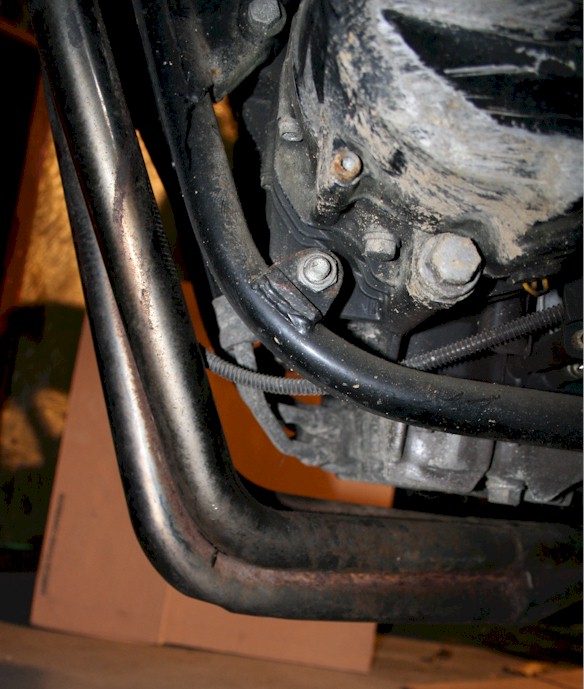

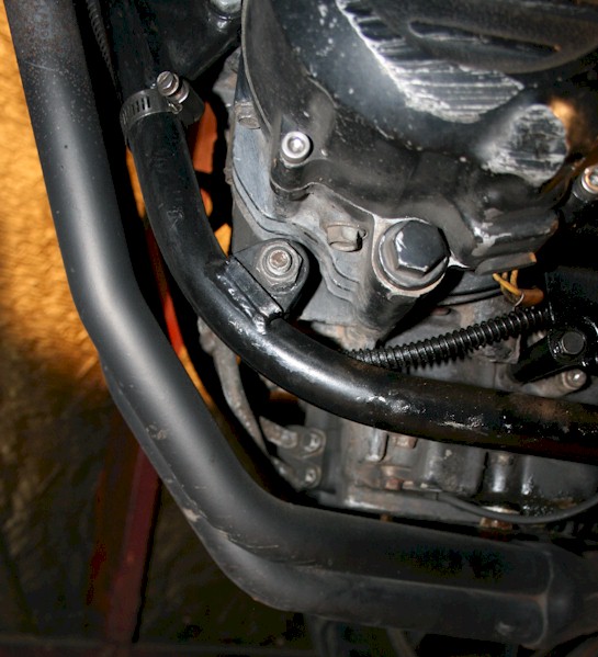

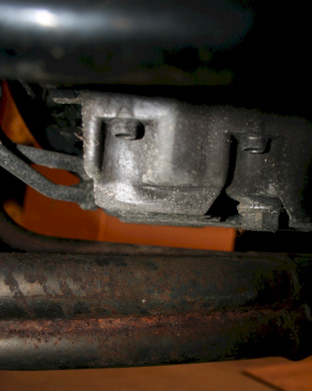

Well I was able to tweak, what I think are 650 pipes, pretty easily to fit the 550 head. But as you guys said the results are not the same as using a 550 header.
The 650 pipes hang down roughly 1/2 inch lower, and stick forward maybe 3/4 inch at the lower elbows.
Here's bottom clearance for a 650 header on a 550.
Here's bottom clearance for a 550 header on a 550.
Here's front clearance for a 650 header on a 550.
Here's front clearance for a 550 header on a 550.

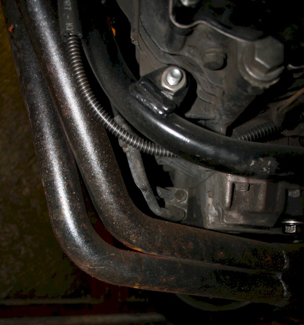

Way to go Lou. Just to add the ZX600 C Model (1985-1987) should also have the same spacing. I have 2 of these headers, and have got both to fit, but didn't check how far they hang down.
Here is how close the street system on Elvira sits to the engine:
Good luck on your fitting issues.

Thanks Corey,
That pipe is nice and tight against the motor!
