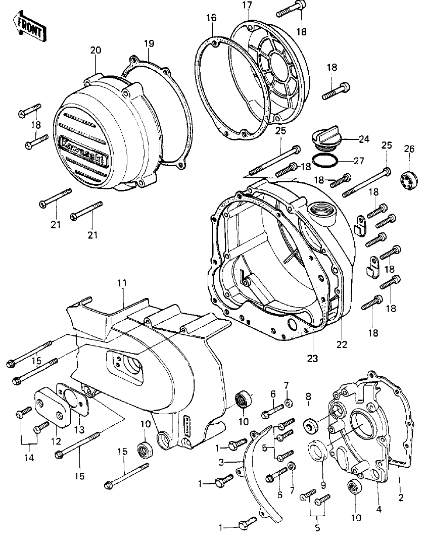

Individual Seal #92051-005 Inner Trans Door, No.# 10 on the Kawasaki Fiche for "Engine Covers"

Re: KZ750E Shifter Seal. Where to find??
08 Mar 2013 02:15
#575936
I edited my post so you could view the picture...
