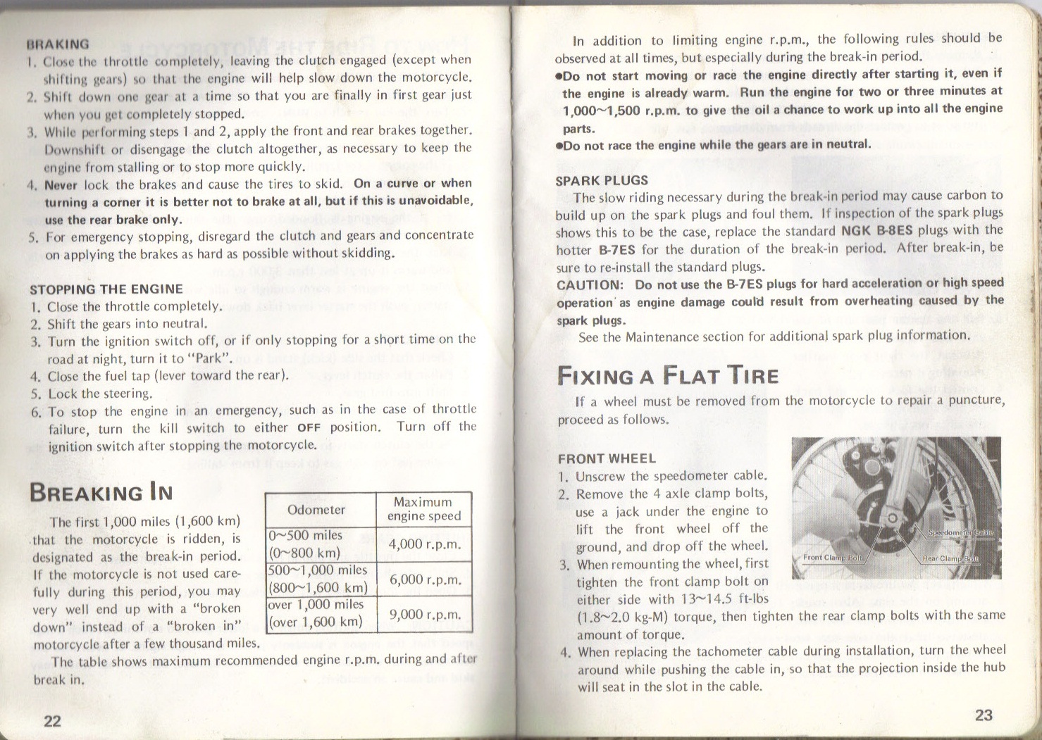

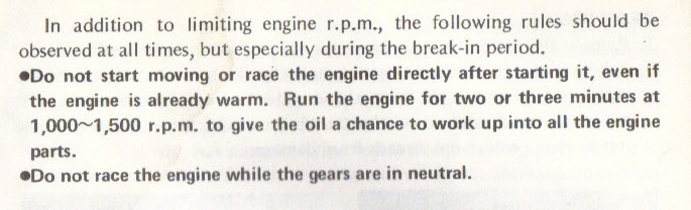

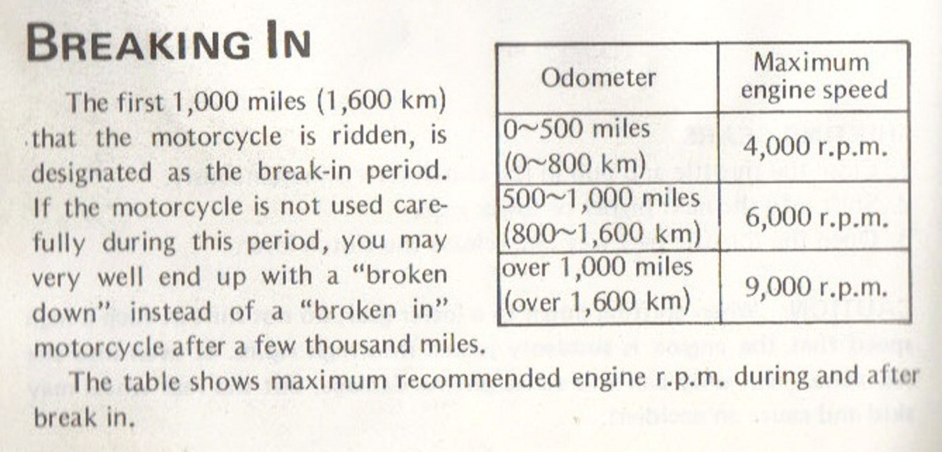

For comparison with factory recommended break-in procedure for a brand new motorcycle.
This would be an ultra-conservative method for break-in following the reported engine work.
Varying the engine rpm while on the road is also recommended.
That is to say, don't hold a steady rpm for prolonged periods.
Last edit: 04 Mar 2013 11:41 by Patton.

04 Mar 2013 19:39 - 04 Mar 2013 19:40Patton wrote: For comparison with factory recommended break-in procedure for a brand new motorcycle.
Those RPM ranges with mileage were on the tachometer in a clear overlay on my new KZ750.
