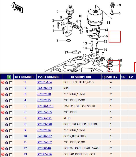

I've got a leak from the pipe and it looks like there are 3 " O " rings that can be replaced
Is that right because it seems like there should be one more ?

Correct three different sizes that can be replaced but there are two of #3 (that go on engine case) so there are four total.

Cool Bro I see that now, thanks

I went to sears hardware and they have any o-ring you will need....43 cents out the door. I just put a oil cooler on my bike last week and needed the same thing.
There are 4 o-rings. 2-18mm 1-15mm and the oil pressure switch.
Goto NAPA or so and ask for a (2) -18mm for oil pipe to cases and take oil sensor for fitment.....they will have it.

:woohoo: a nice cheap fix :woohoo:
Thanks 4TheKZ1000
