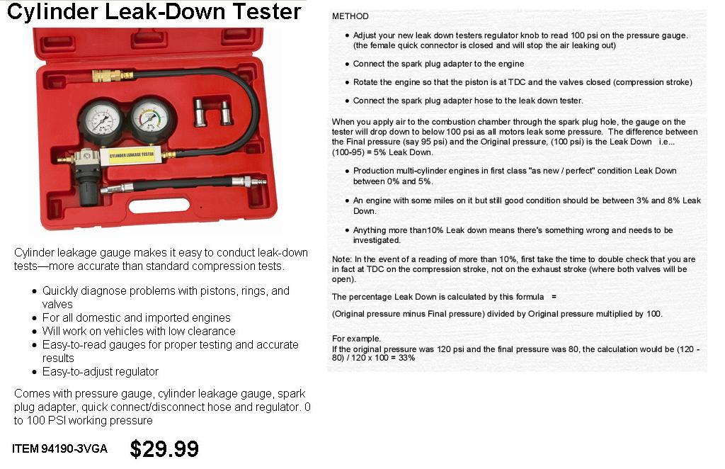

If it did go boom hard enough to cause your head gasket issue you might want to do an actual leak down test to see where else its blowing out to make sure the rings are still sealing if the motor is still together.
You can always check the valves for sealing after head is off if its already apart. B)

What is a leak down test n how do ya do it,,,iternet porn,,,,hehehe
  • Old Man Rock
  • Old Man Rock's Avatar
  • Posts: 6224
  • Thanks: 225
Re: Rookie wrench and a head gasket
27 Jan 2013 11:38 - 27 Jan 2013 11:39
#569497
Harbor Freight Tools... Worked just fine on my builds... ;)
