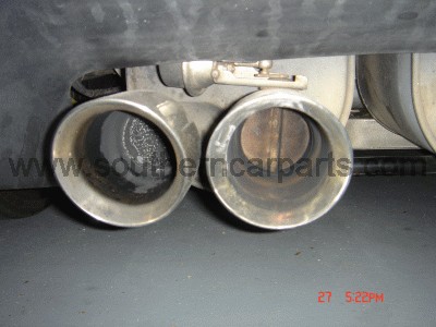

31 Jan 2013 18:52
1983 KZ1100-L1 "LTD Shaft"
Wiseco 10.5:1 1171 piston kit, bored by APE
Dyna 2000, Dyna S, Dyna grey coils, WG coil power mod, CB900 starter

I'm not sure what's going on in that pipe, so I can't say for sure.
An update, though, is that I made one of these: www.dynatechheaders.com/access_vortex.html
I can't upload a picture of the one I made, for some reason. Stupid internet.
But research has revealed that these cones reduce volume but don't increase backpressure. So I'll have to weld the big-ass washer onto the mounting plate!
