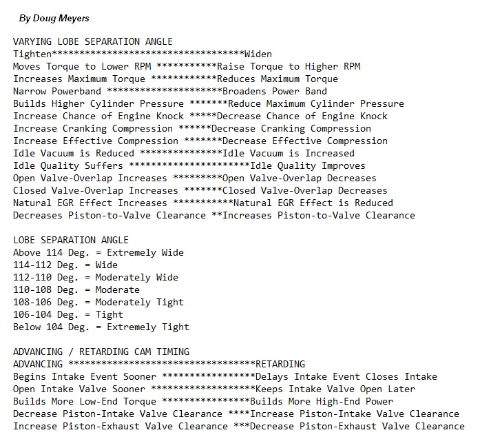

by Doug Myers... Can't explain it any better than this....

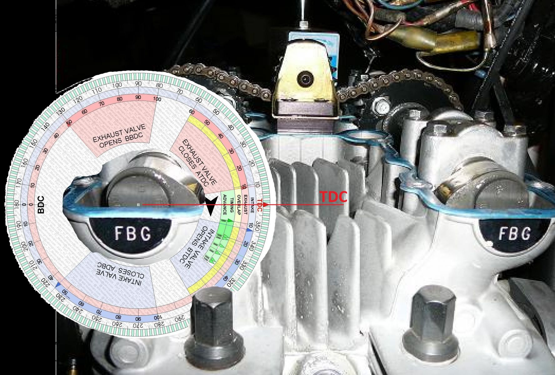

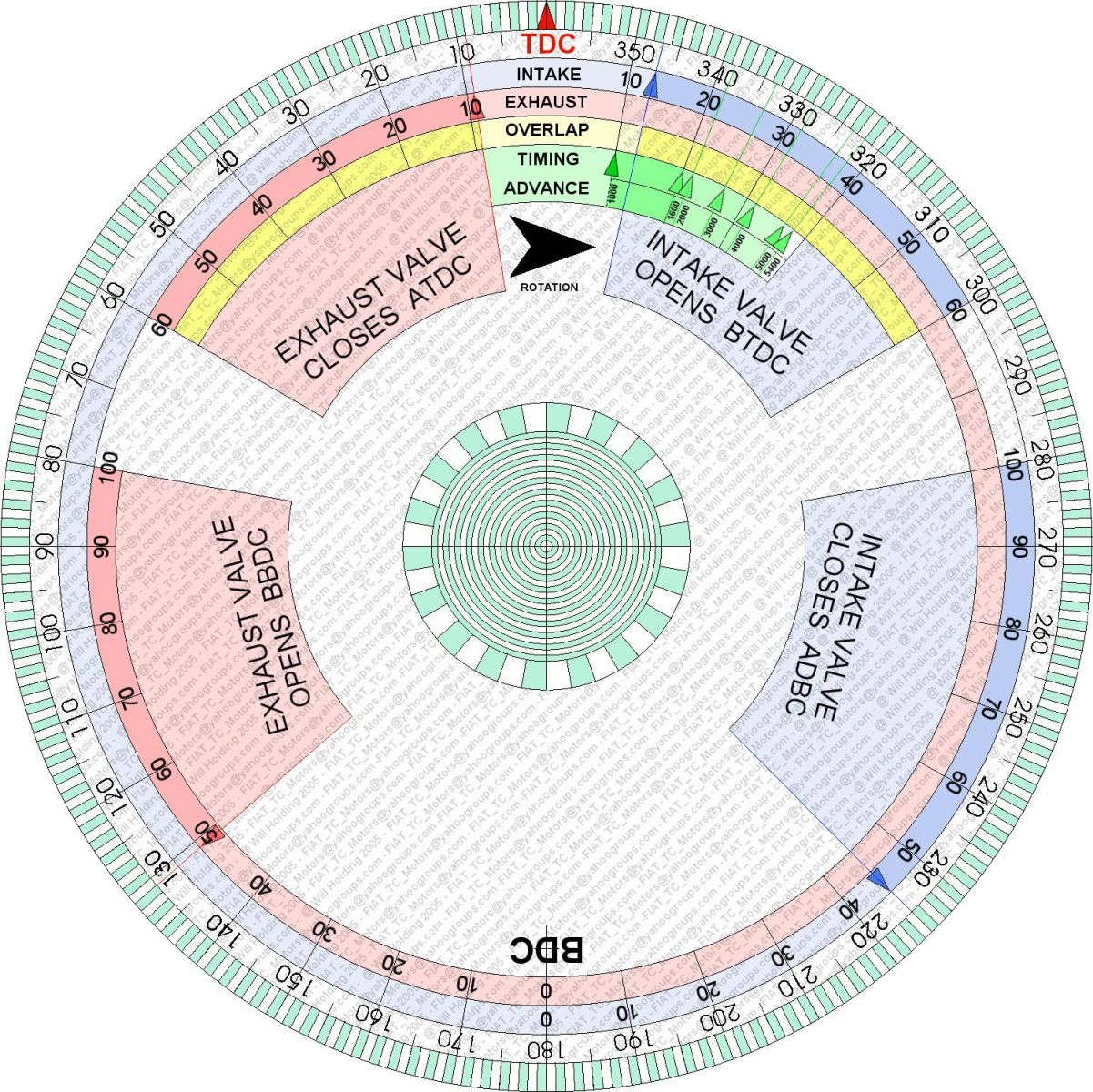

Found this image of a cam degree wheel, may help put things in better perspective as well...

I like the degree wheel. I spose a person could print that out big and glue it to some cardboard = free degree wheel! :laugh:
