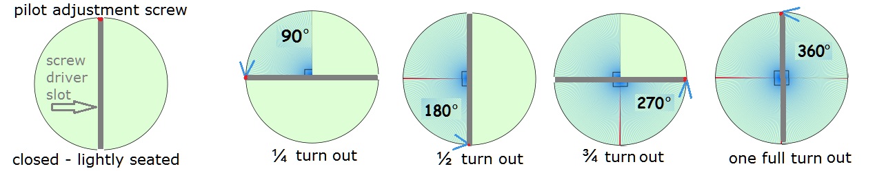

jason289 wrote: When adjusting air screws does 1 turn mean 180 degrees or 360?haven't figured that out yet.
:huh:
my telephone area code is 360-xxx-xxx if that helps
  • Patton
  • Patton's Avatar
  • KZr Legend
  • Posts: 18640
  • Thanks: 2100
Re: engine bogging down on freeway/high rpms
03 Dec 2012 23:40
#561253
jason289 wrote: ...When adjusting air screws does 1 turn mean 180 degrees or 360?....
Refers to the number of degrees in a circle (or parts of a circle).
One full turn is 360°.
One-half turn is 180°.
Good Fortune! :)
