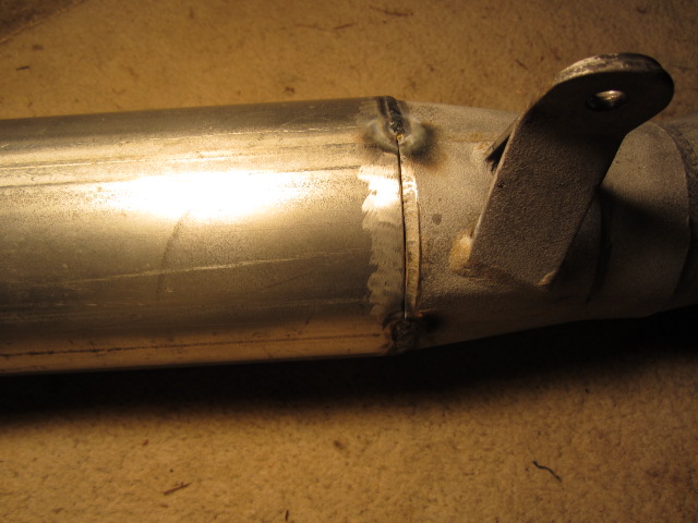

To tell you the truth, these modern(read cheap azz corner cutting rip offs)pipe manufacturers can take a queue from some of the kings of pipe building from the 70s-80s.
To keep that from ever happening braze a sub plate on the pipe then braze the mounting tab to the plate. It won't crack, gauranteed.
Here is how the Bassani mount is atached to the meg/canister section
and that's it mounted in the factory rubber isolator.
I just got through repairing my canister section with a new section of 4" pipe. Huge can collects large quantities of moisture, creates huge rust problem. New aluminized pipe with weep hole fixes problem area :cheer:
