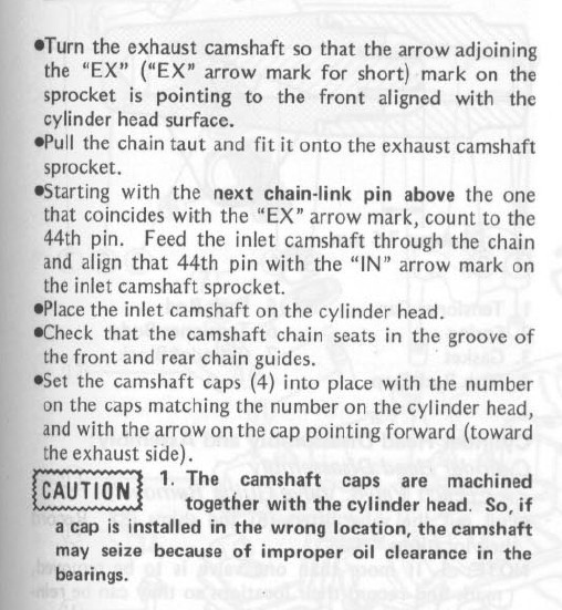

anyone have a picture of the steps to set cam chain timing?? seem to have misplaced my service manual..thanx in advance...

Replied by Motor Head on topic setting cam timing
Use the link in my signature for a pdf version of the service manual. It will have all of the info.

for whatever reason i cannot open it..all i need is the pin count from intake mark on intake cam to exhaust mark on exhaust cam..

Replied by brianrae33 on topic setting cam timing
computer just being stubborn..pin count for 1982 kz1000 ltd is 44 and not 28?

by Motor Head
The following user(s) said Thank You: brianrae33
