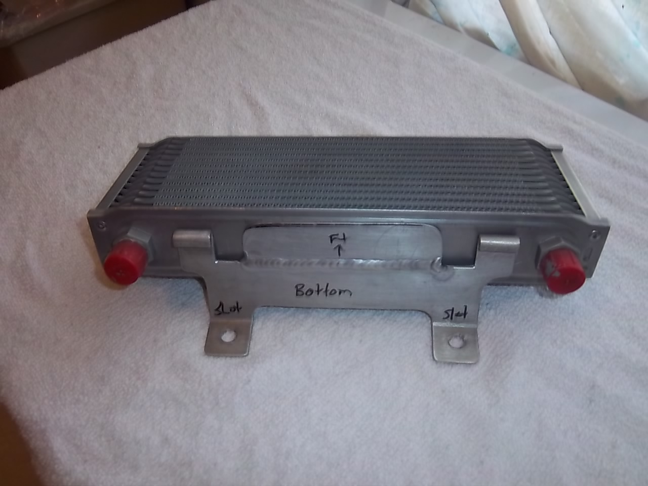

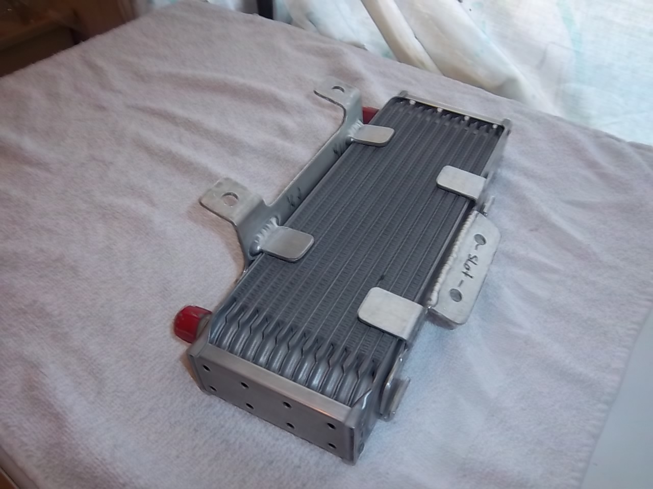

04 Jul 2012 12:47I posted this on kz1000r.com also, but wanted to share it here also,
This is just a shout out for anyone wanting the s1 style cooler. Summit racing has it for $112.00 but no hoses. I bught the same one and cut top and bottom rails off, then re riveted the side panels in after drilling the holes. ty/steve

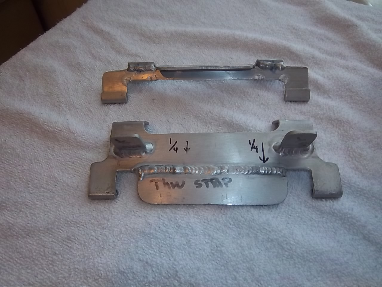

04 Jul 2012 13:50I wiil et more pics ltr, I will use an-8 fittings. I made a prototype mount
and am looking for someone who can remake it. here is a pic,ty.steve

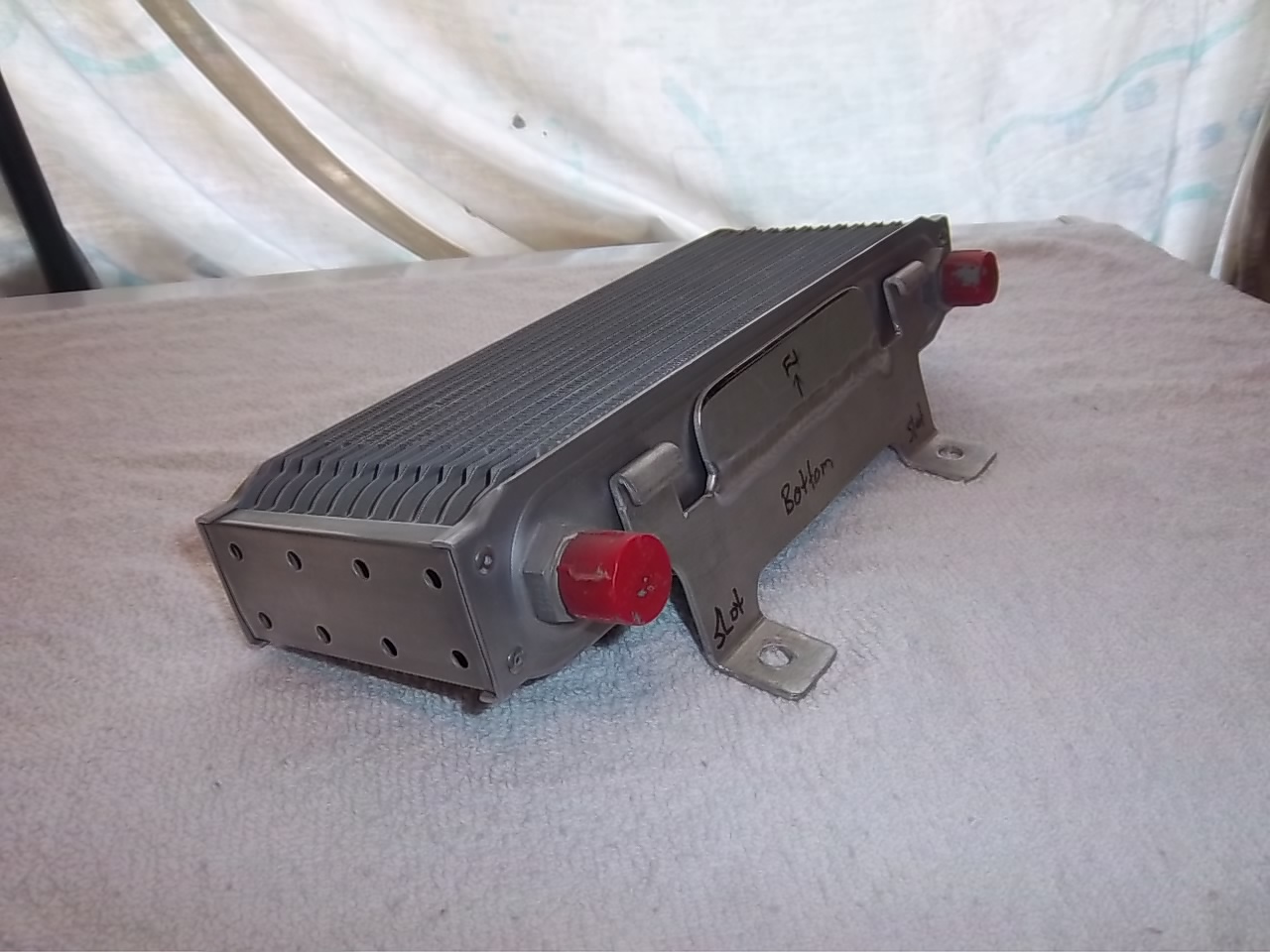

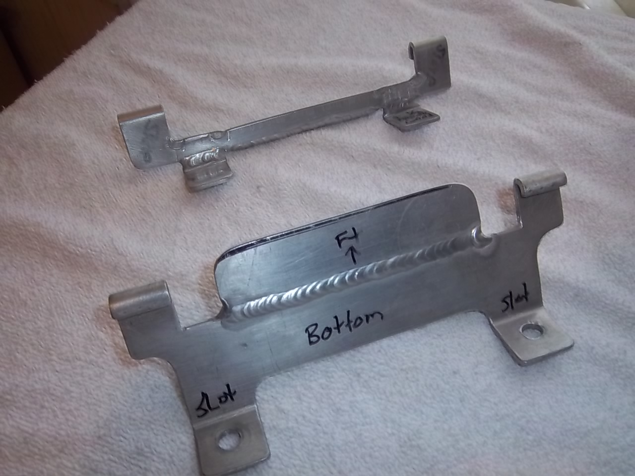

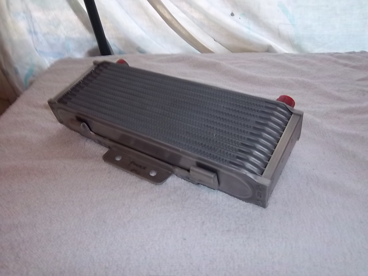

Here are the pics of my cooler,anyone out there who can remake the mounts?
They are set up for a kz1000r-1983.and will use oem rubber strap to hold in place.
this is setup like the s1.steve.
sorry for so many pictures.
