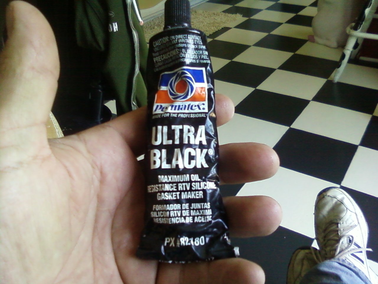

I don't think you want it to get hard, :dry: this is what I used on my stator cover grommet and it's holding up good so far.
Make sure you clean the grommets and wires real good first and pull the wires out to get the hidden oil, then after they're dry coat them with your sealant and pull them back into the grommets and dope it up real good.
Don't forget to buy a new gasket for the cover.

That Ultra Black is very good stuff, Used it for my rebuild on all kinds of gaskets.

i use Permatex Ultra black rtv silicone on most things. as long as u understand the pros and cons it works well.
the reason i like it so much is that its easy to remove . if u r the kind of guy that has covers and things off a lot you will appreciate that. u can usually re-use the gaskets if u use this suff. the down side is that u need to pay attention to how much u put on. if u gob it on and tighten the covers, it will squeeze out on both sides(inside and outside the motor). i have heard reports of guys finding bits if the silicone on the oil pump screen.
i love that the tube has a long thin cone type tip. i can cut it to produce a thin1/16" film on the parts. when i'm done i don’t recap it. i just squeeze out about a 1/2" of silicone and let it drop down to the cap, then let it dry. when i need it again, i just pull this 1/2" piece off and i'm good to go.
if i have a gasket that wants to squeeze out, i put a thin coat of sealer on , then just snug the bolts up so it wont squeeze out. then i will let it dry overnight before tightening the bolts up properly.
I like Yamabond or 3 bond too, Lots of guys use and love this stuff. I do too, but not as much as Permatex for gaskets.

The red stuff is used in place of gaskets. It works very well on my bike never hardens, never leaks and cleans off easily. I would also recommend the RTV black for what you are doing. Something like Yama-bond is probably what was originally used. They sell it at the Yamaha dealer.
