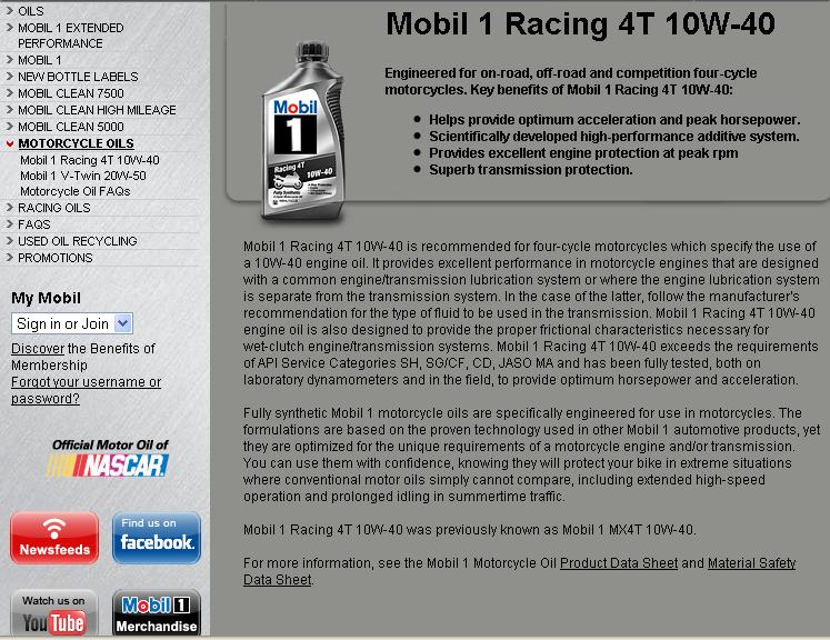

Re: Sufficient Break-In Mileage For Synthetic Oil???
26 May 2012 12:03 - 26 May 2012 12:04
Yes, there are synthetic oils that meet the JASO-MA standard for motorcycles with wet clutches. Make sure whatever oil you buy states on the container that it meets that standard. Here's what I have been using for the past 5 years and I highly recommend it. It is formulated specifically for bikes like ours.
www.mobiloil.com/USA-English/MotorOil/Oi...acing_4T_10W-40.aspx

- Old Man Rock
- Posts: 6071
- Thanks: 225
26 May 2012 12:20
26 May 2012 12:21
Awesome, thanks for the info. I was wondering about the clutch. I used Slick 50 when it first came out and it ruined my clutch....wasn't made for wet clutches back then.
Mobile 1 is a very well know synthetic oil...I'd be pretty comfortable using that. I didn't realize they made a specific motorcycle oil so that's great.
