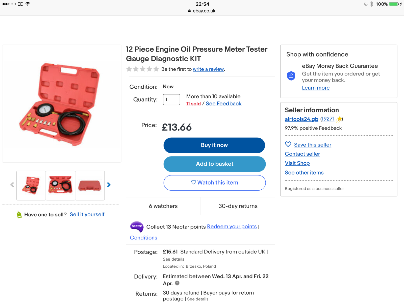

I haven’t, I don’t really have any way or knowledge of how to. Any tips to do this easily?
- Posts: 6878
- Thanks: 4330
Re: Engine Knock - kz1000
06 Apr 2022 14:56
If you can get hold of a gauge you should be able to remove the oil pressure switch and screw the gauge in it's place (like all tools the range is huge but entry level isn't expensive and very useful to have)

06 Apr 2022 15:38
If you are going to get an oil pressure gauge, be aware that automotive ones likely will do you no good. Your KZ has about 3psi at idle and most gauges do not read that low.
