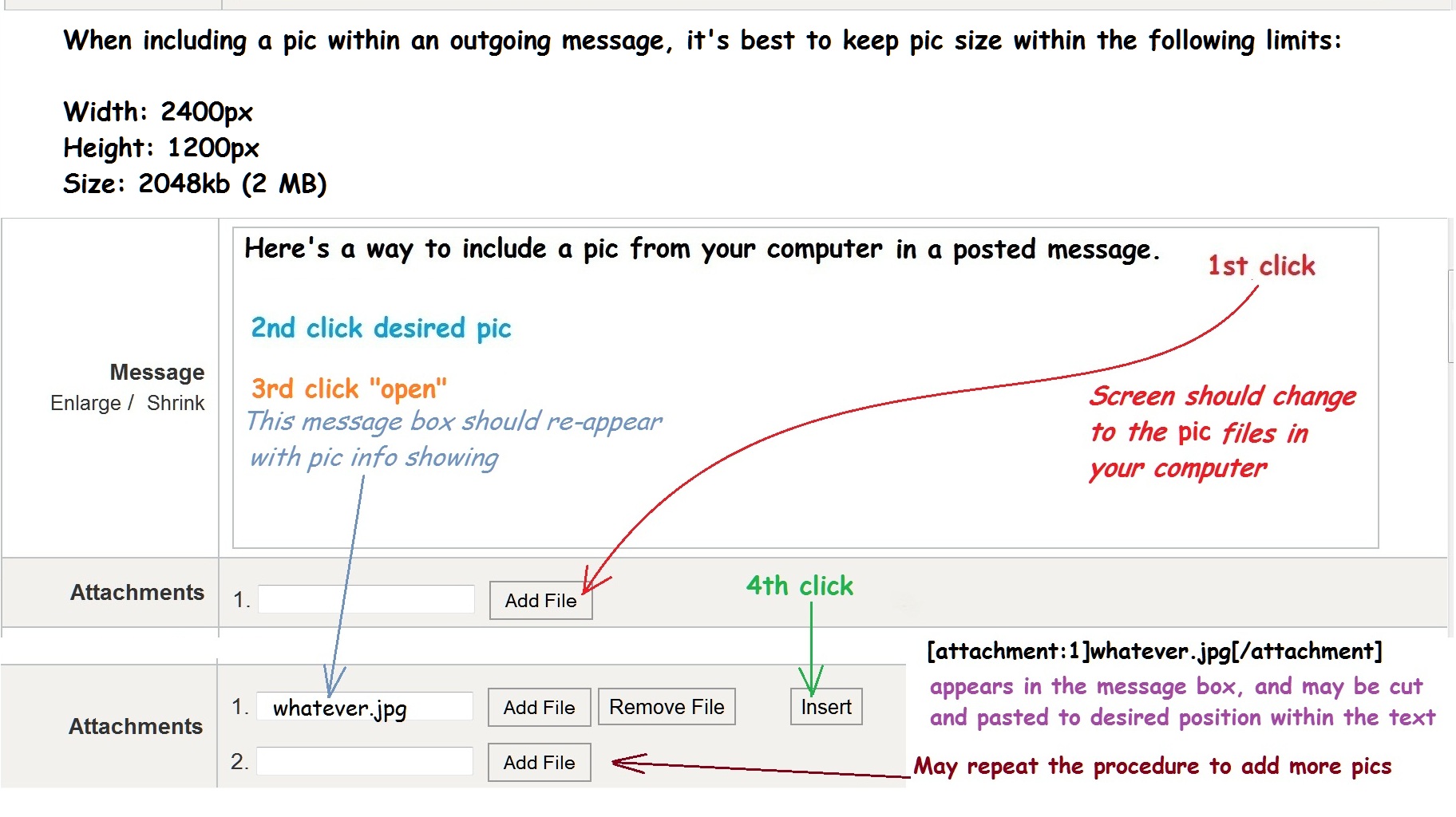

When including a pic within an outgoing message, it's best to keep pic size within the following limits:
Width: 2400px
Height: 1200px
Size: 2048kb (2 MB)
Click here > Include a Pic in your post

LOL thanks Patton that was actually a video I was tryin to post. Here is the link
