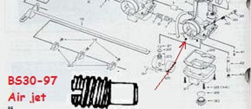

Regarding the smoothbores, if not already done, would remove and clean the air jet.

Okay I did not clean the air jets - I'll give that a try!

Be sure the screw driver tip is a perfect fit into the jet.
And if the air jet seems stuck in position, might also consider a lengthy soak with Kroil, PBBlaster, Liquid Wrench, or other penetrating oil.

I took the carbs off and one air jet came out easily. The jet was clear and I sprayed carb cleaner down the passage. The other three jets were stuck and I just blasted them with the carb cleaner, not wanting to soak them yet.

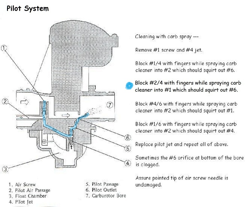

29 smoothbores should produce a strong steady idle at 1200 rpm.
Perhaps another cleaning (see images below), manometer sync, and fine tuning with pilot air screws would be in order.
When fine tuning the pilot circuit for best idle, should attain highest rpm via air screw adjustment, then use the thumb screw to lower the slides. Do this for each individual carb, and repeat until no pilot air screw adjustment will raise rpm.
Do not use the pilot air screws to reduce idle rpm. The correct pilot air screw adjustment is the screw position that produces the highest idle rpm.
When performing the bench sync, be sure the idle thumb screw has sufficient thread remaining available by which to later lower the slides during the later running sync and fine tuning.
Where this hasn't been done, the tuner may erroneously attempt to further reduce idle rpm by turning the pilot air screws (which simply screws up the pilot mixture).
And would also confirm valve clearances being within specs.
If not already done, would assure fuel mixture from the pilot circuit exits freely through the orifice into the bore.

Patton, your help is just fantastic. If I recall correctly, when I change the pilots and mains I did not go through this cleaning procedure. I'll take them off and give this a try.

Well Patton, I cleaned the pilot circuits per the pics above and saw a steady flow of cleaner coming out of #6 for each carb. Also re-sprayed cleaner into the air jet inlet.
Result - the same, doesn't idle well.
