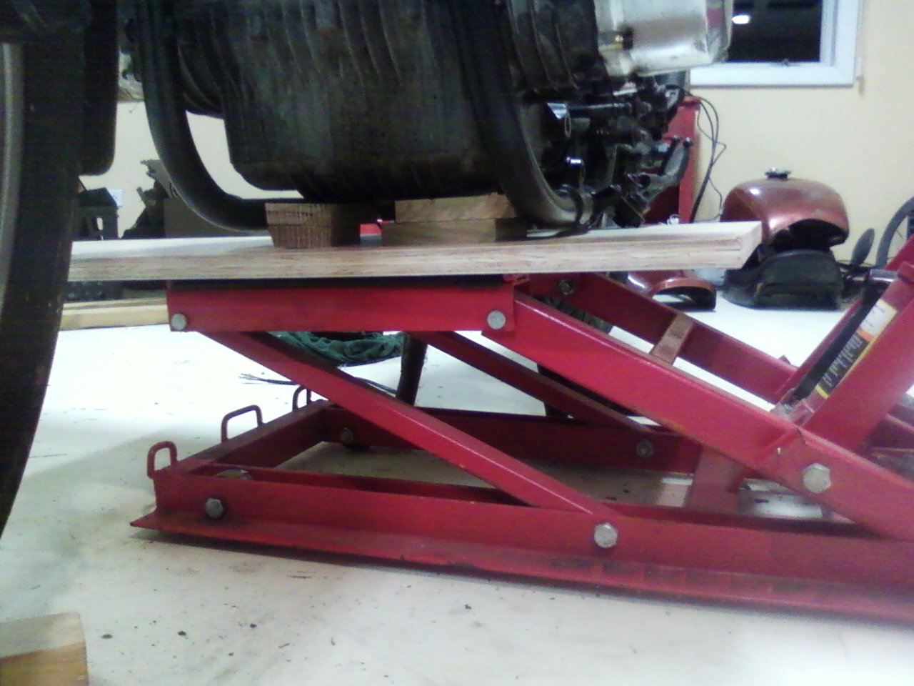

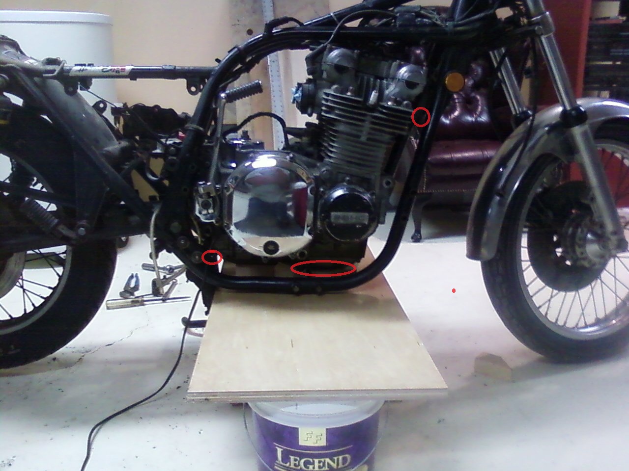

I borrowed a bike jack from a friend to get an idea for a comfortable height to make a work table.
But I found out that the engine got in the way, and that gave me an idea.

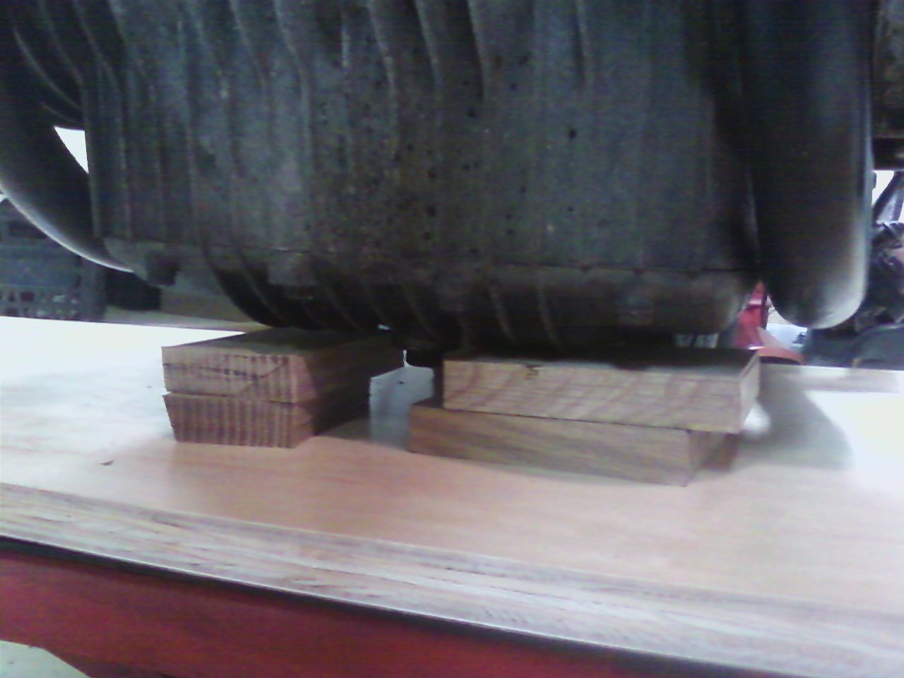

I have a bunch of hard wood laying around so I just started experimenting .

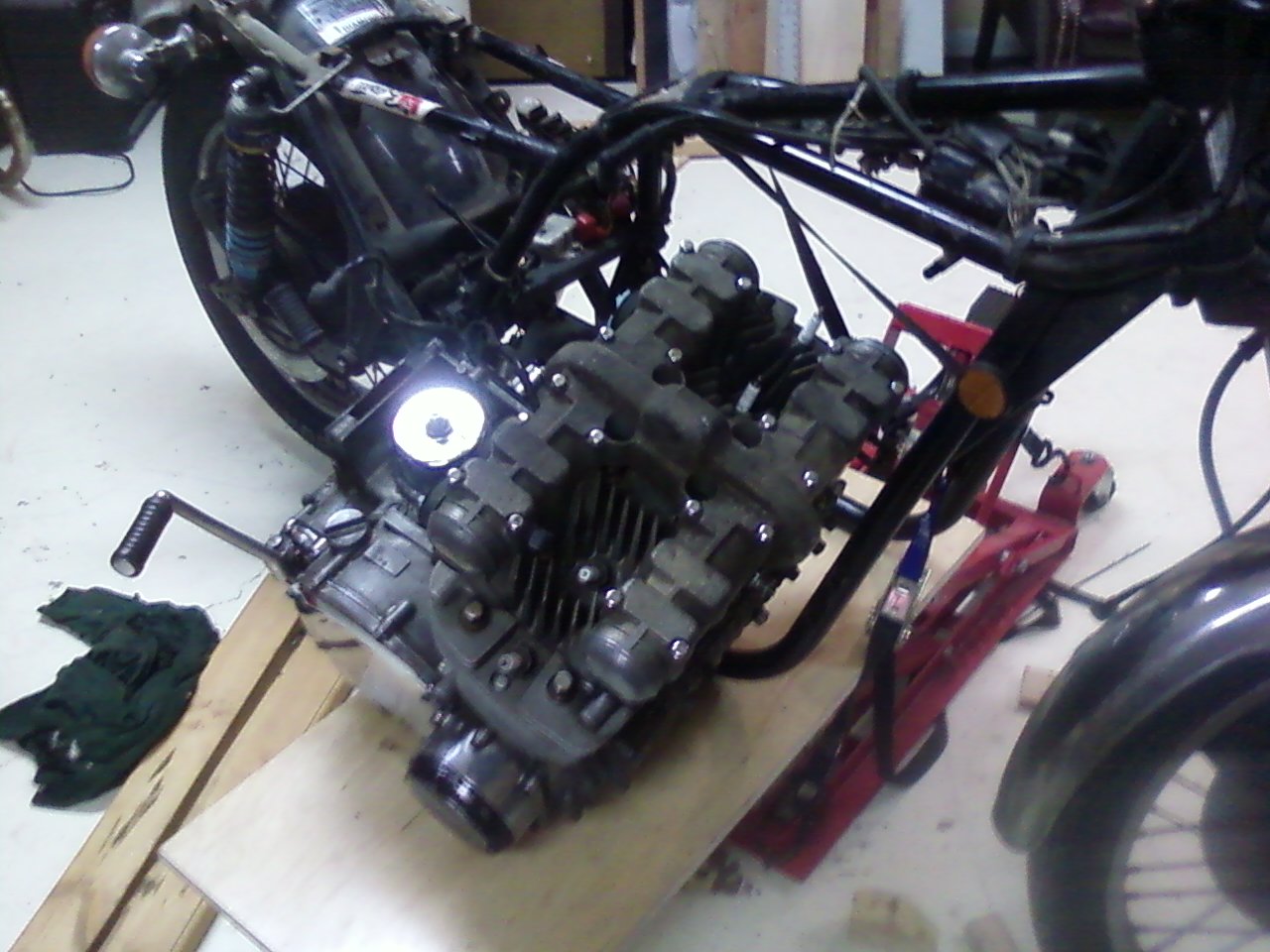

It came out pretty easy for just one guy, the big hang ups are the cam chain cover , exhaust studs ,
the lower engine mount by the kick starter and the lug for the oil filter.
I think I rotated it counter clockwise a little and tipped the jugs out to clear the cam chain
then lifted it to clear the filter lug and it fell out.
I highly recommend another person to hold the bike , add or move shims and help with the lifting,
and next time I will fasten stop blocks down to the board on ether side of the frame to keep it from moving around and straps are a good idea.
Another idea is to put the nuts on the exhaust studs to protect the threads and frame
